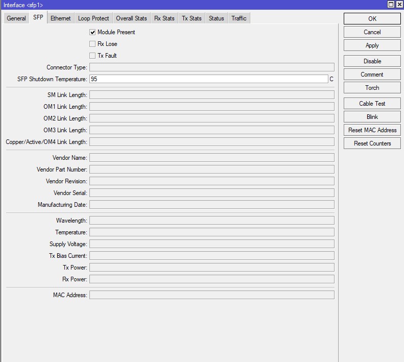

Recently I’ve found that all of the information for the SFP interface is missing on v7.1.1. At the moment there is no information listed at all, something that was present in v6.x.x. Currently using Hex S and S-85DLC05DI module. Anyone having the same problem on v7?

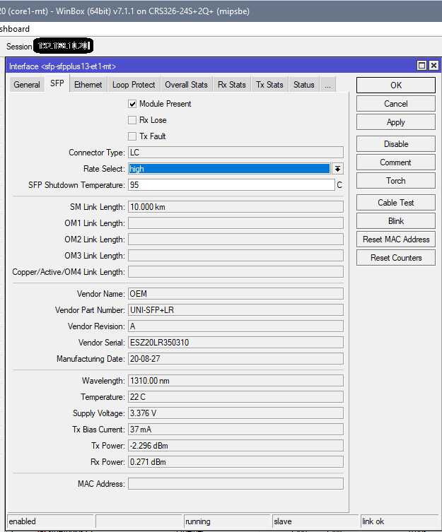

It´s not a general bug in V7.1.1, because in my ARM and MIBSBE devices all SFP+ interfaces reports correctly.
Unfortunatly I have no MMIPS device running with SFP modules to verify.

It seems to be working for you. Interesting enough it was working on v6.x.x without any problems. I’ve tested it now with another SFP module and it seems to not be from it. With both modules the problems remains. Don’t have a SM module to test but I’d say that this is most likely coming from the v7 and as you mentioned it isn’t a general thing for all SFP modules and architectures. The connection is working fine but no information. I’m using OM2 cable.

A quick update on the problem with the missing information from the SFP module on my Hex S. I’ve tried some things in order to resolve the problem but nothing seems to be working, tried even the v7.2 but without any success. Few minutes ago I downgraded back to 6.42.2 and surprise everything on the SFP worked as expected. Now I’m more than convinced that this is a problem with v7 on Hex S or MMIPS in general.
