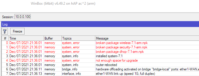

What happened? How to upgrade to v7.1?
(this attempt done through Check For Updates from Channel: upgrade)
Didn’t you read any of posts in this thread? The only way of installing ROSv7 on de-bundled ROSv6 hAP ac2 is netinstall.

Serious question. How to upgrade the flash storage on hAP ac2?
If I want to install a wifiwave2 14MB package to a 16 MB storage size …
Is it possible that Mikrotik will provide a path where we can have RouterOS v7 with wifiwave2? Or is there a way to desolder stock flash chip and solder a larger - perhaps 32MB flash chip?
