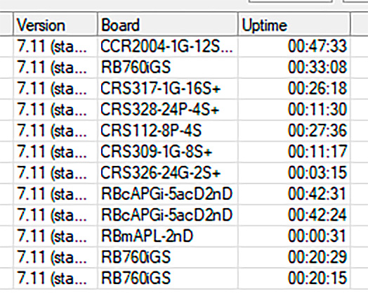

Just da smol home-network:
Found no issues.
Found no issues.
