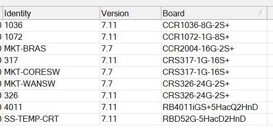

so far upgrade for 1036,1072,317,326,4011,HAPAC2 went without a hitch

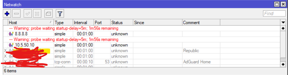

RB750Gr3 nice warning before start

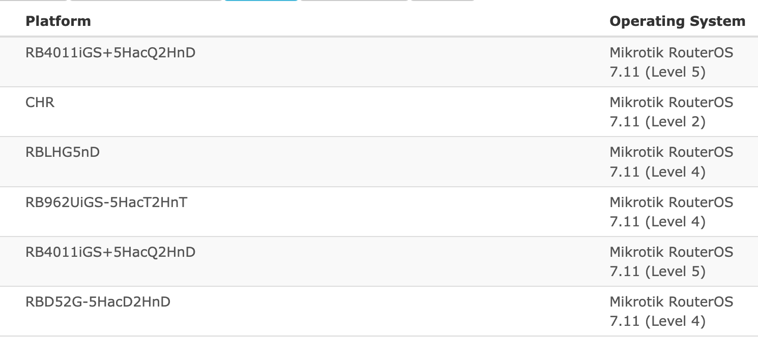

All updated without a problem :slight_smile:

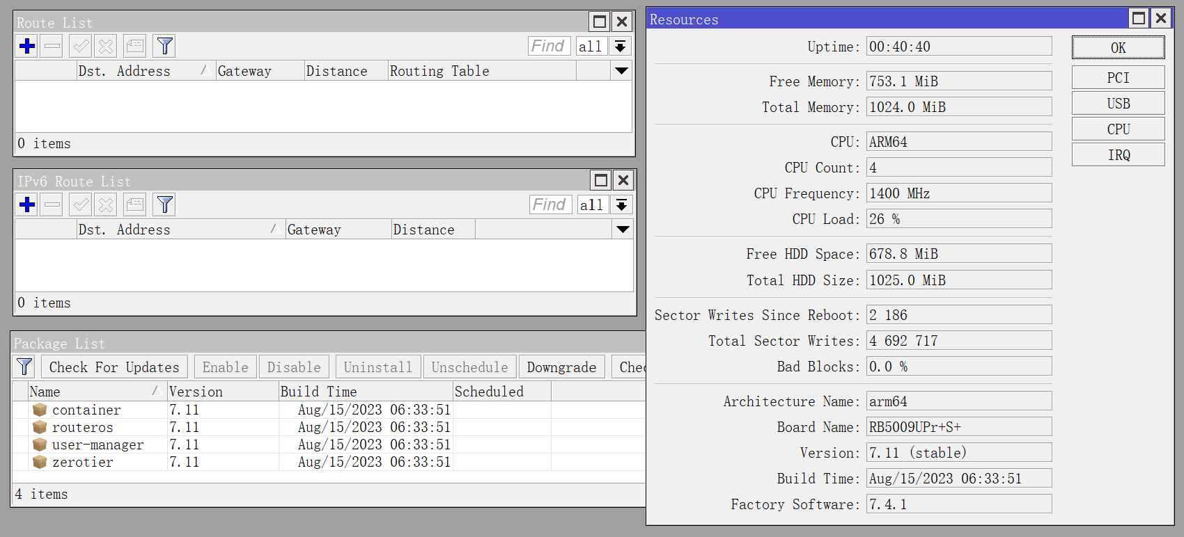

[RouterOS 7.11] RB5009 after upgrade to 7.11 route empty and cannot output suprif
