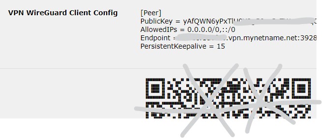

BTH QR code looks odd in Winbox. It looks OK in WebFig.
