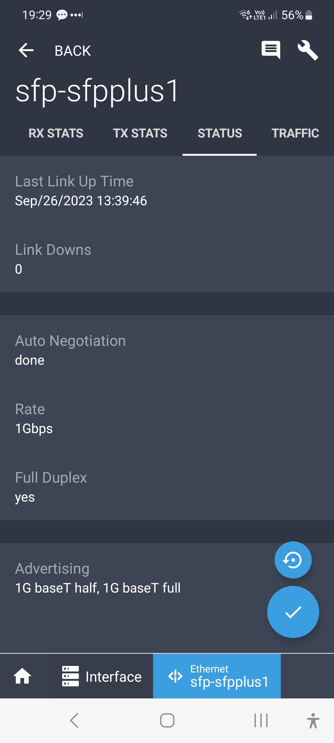

I have S-RJ01 in RB5009 at home, works just fine using latest beta.
