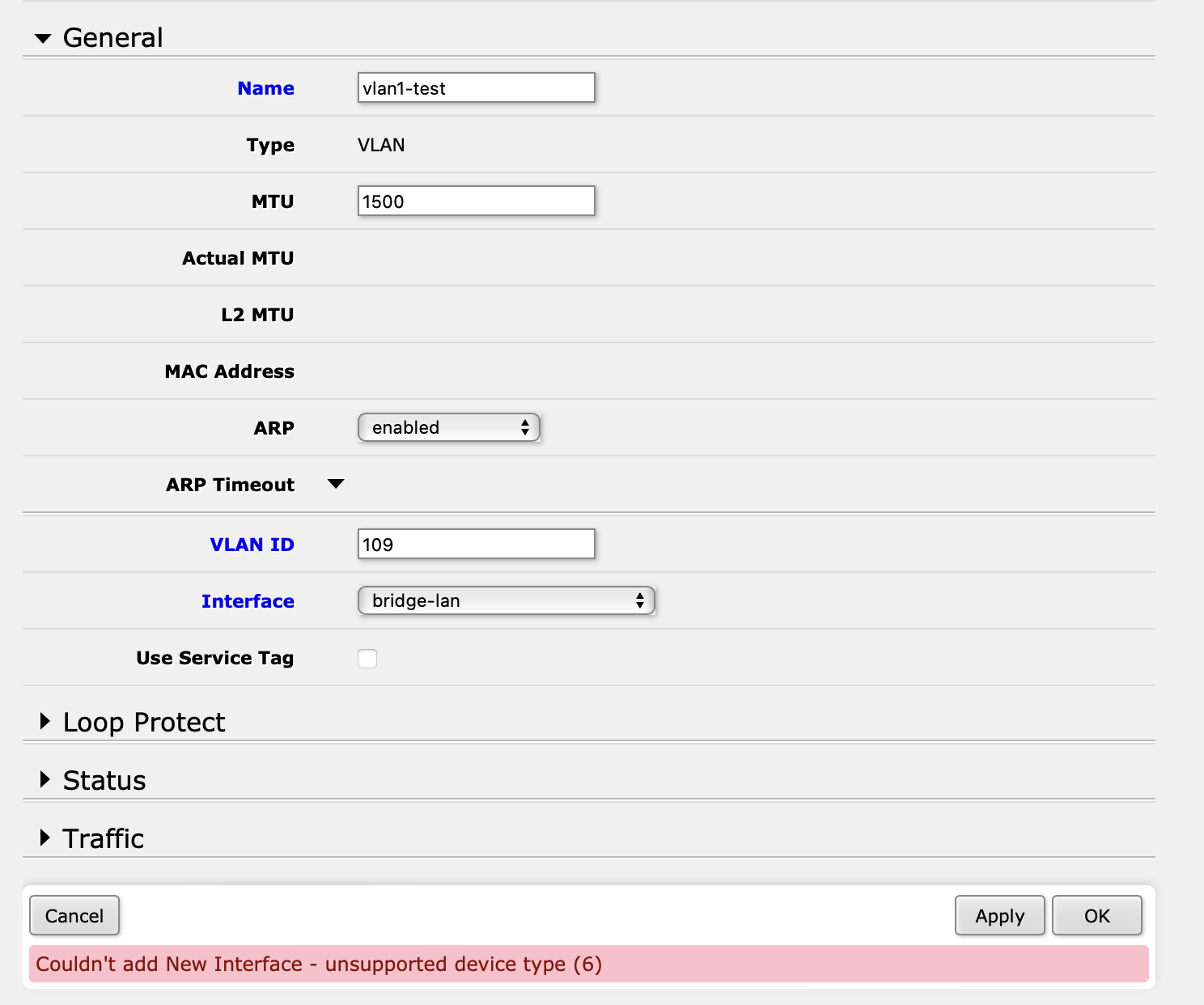

On both builds 7 and 9, when attempting to add any kind of dynamic interface (bridge, VLAN, bonds, IPIP/EOIP tunnels, etc.) from within Webfig, I get an error that the interface type is not supported.
This is happening on hAP AX3 and CCR2116, with completely different base configurations.
@sirbryan hAP ac3 (ww2) also has this issue.
I can confirm it is the same on CCR2216, although the CLI command still works, so it looks like it’s some sort of web ui specific issue.
Yeah, support acknowledged it as well. I did what I needed to with the CLI, but wanted to report it here.
