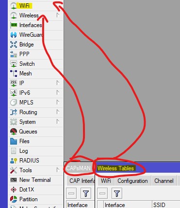

But for clarification regarding “Wireless” and “WiFi”:
- Can I uninstall the old “Wireless” package on devices without WLAN-interface (like Switches), or will this break something (like CAPsMAN-management traffic or something)?
WiFi is always there, but useless?
- On devices like the mAP lite, I have now a WiFi button plus a Wireless button. But nothing in the “WiFi” menu.
There is no additional driver in the MIPSBE-Extra-package. Means WiFi is always there, but useless?
- Devices without the additional driver ( ‘wifi-qcom-ac’ or ‘wifi-qcom’) have to run everything WLAN-related under the old Wireless-Menu?
To my understanding:
1- yes.
2- correct, consequence from having (wave2) wifi in base package now.
3- yes. See also 2.
@Mikrotik, please update the Menu-Name from WiFi Menu to WiFi NOT Wireless!!!
This is totally confusing o_O
1- yes.
3- yes. See also 2.
Thanks!
It’s not useless, it can be used as Capsman to manage devices using new wifi driver.
It’s confusing, if device A doesn’t have wireless chip/features, then “Capsman” should be seperate menu altogether, not “wifi” or “wireless” or “wifiwave2”, capsman is just a control plane protocol.
Like on 1 out of 100 devices its useful and on 99 useless? Useless codestuff imho…
With wifi(wave2) capsman configuration is no longer separate from local wifi configuration. It’s only confusing because it used to be different.
