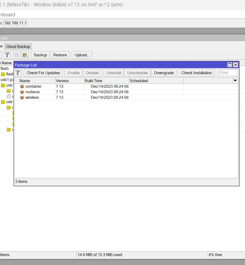

After upgrade on hap ac2 I have zero space left and I can’t even make a backup. How I can save some space? In package list there is a routeros and wireless packages,
Unfortunately it is not only useless (for those that have no intention to use CapsMAN) but it also causes problems…
When you have configuration in winbox to customize windows, e.g. column layout, it is not handled correctly.
Probably the old and new wifi config windows use the same name or ID or whatever how that is handled in winbox.
hAP ac2 is notorious for lack of space. the best is to netinstall it and restore the backup you made BEFORE the upgrade…
You made a backup, right? It says in the first message above:
Before an upgrade:
And also consider the fact that wifi-qcom-ac uses around 200kB more flash space than wireless package. So if flash is running tight (and will be, believe me), then the solution might be to stick to wireless.
If one is using ARM ac device as router only (i.e. wireless is not required), then the new arrangement allows to fully uninstall wireless drivers and thus free a few MB of flash (wifi menu is still there as it contains necessary stuff to run CAPsMAN on same device … but that doesn’t require running hardware drivers).
Something else is using the space, I can also install containers and I still have free space.
