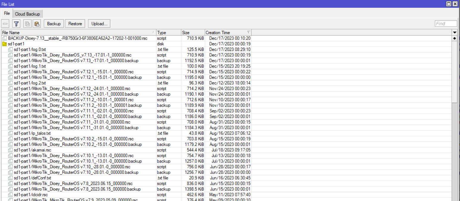

Upgrade sucess in RB750Gr3

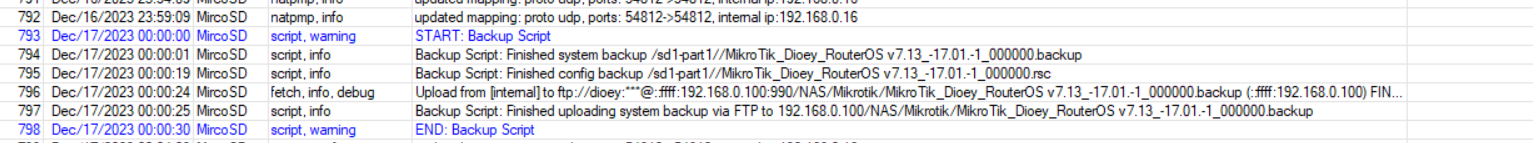

My backup script work only for .backup file but dont work with .rsc file, i am confused which part is doesnt work, the rsc file show in sdcard but i cannot see in FTP server, only .backup file and no .rsc file

can anyone tell me which part should i change from this script
