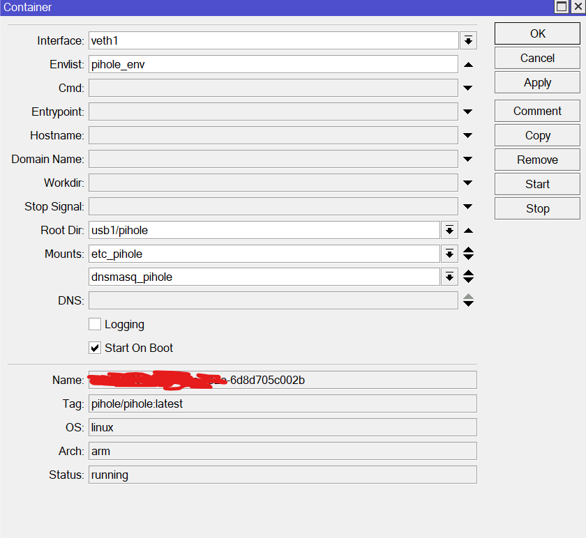

@hova888,
In any case, we need to check the log.
How to do it?
You need to enable logging in the container settings and then check the log messages to understand what the error is.

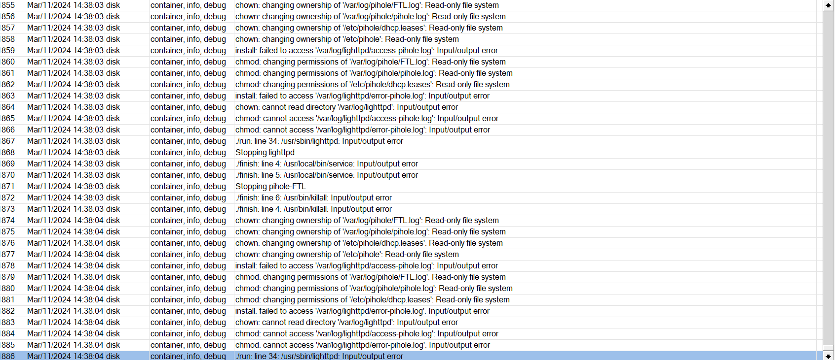

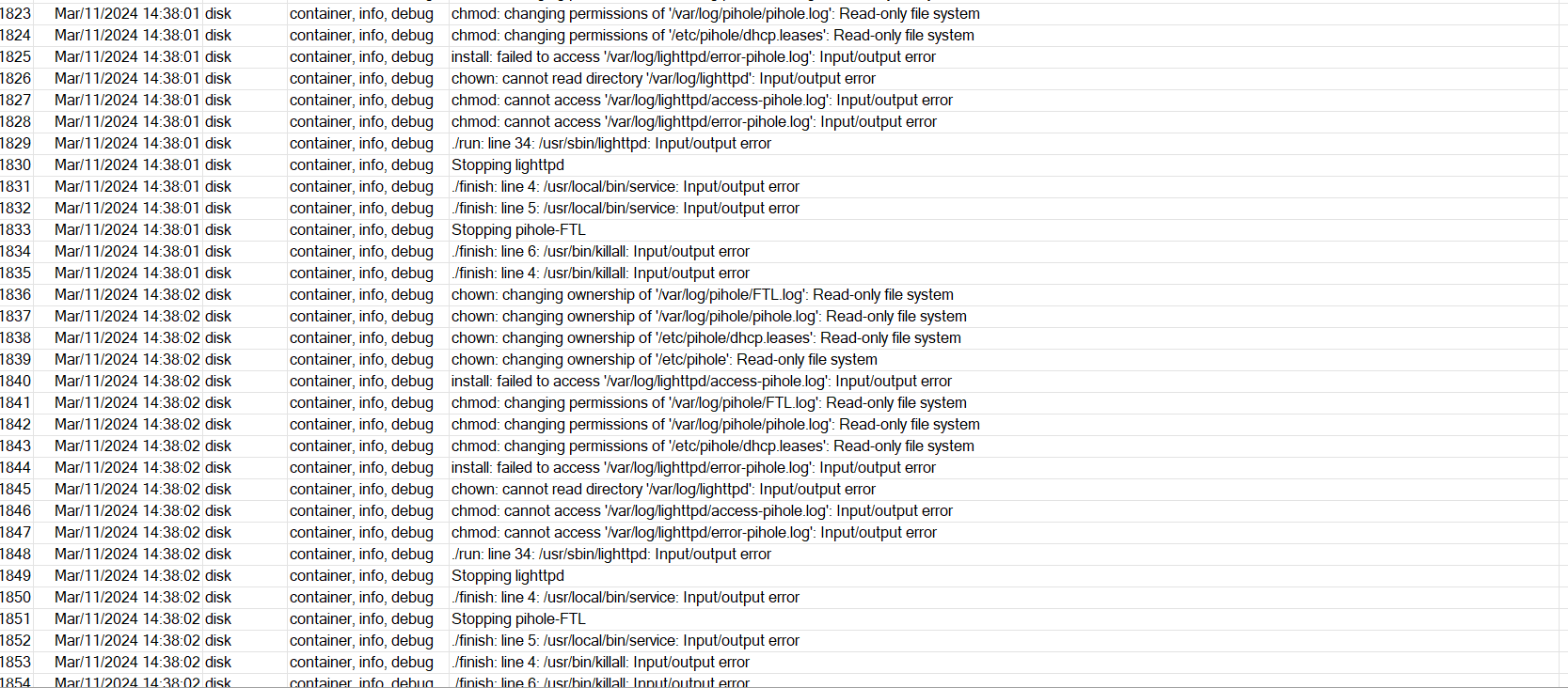

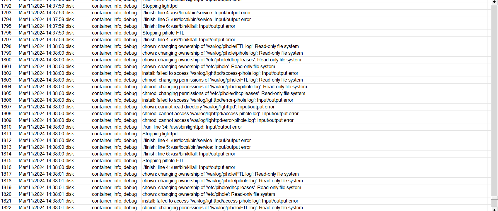

log container 7.14.1
What versions of the solution will you have for my problem pihole 7.14.1 log above in the screenshot?
