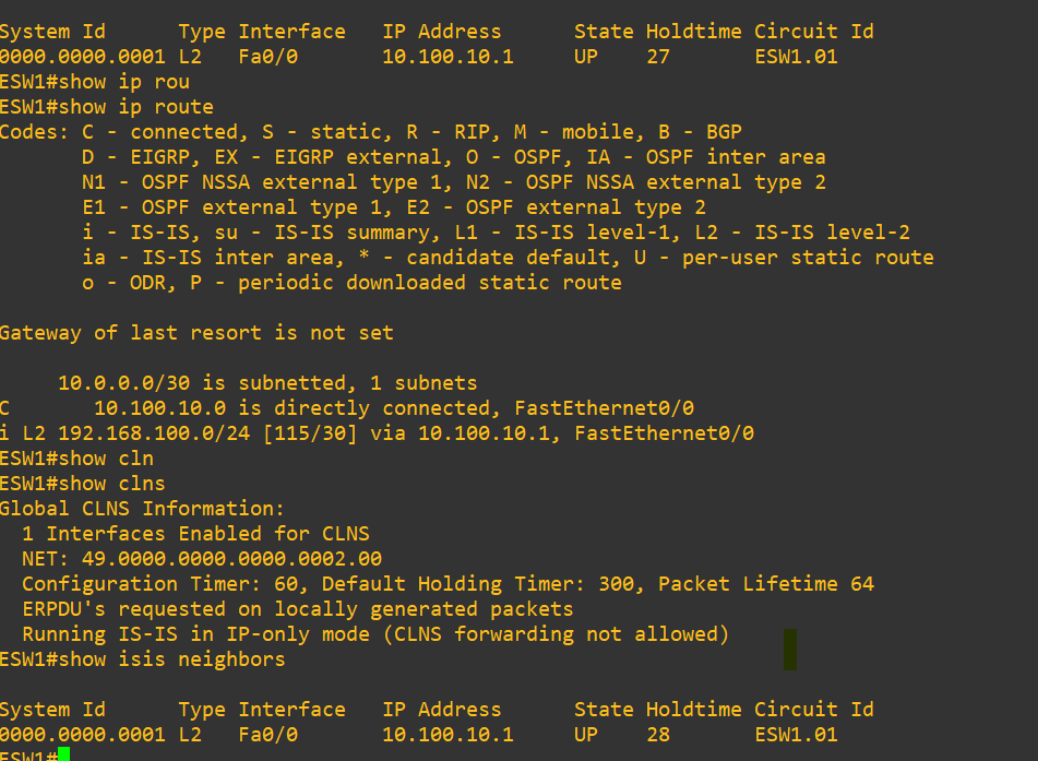

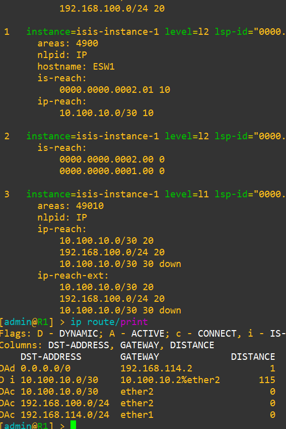

IS-IS to non-MikroTik is not working, tried with Cisco and Juniper
Cisco is not receiving IIH message from MikroTik
Network type broadcast, stuck in INIT state
Network type ptp, neighbor not coming up at all
isis to cisco works for me and there are no isis changes that could break isis with cisco in v7.15beta versions. There must be something specific to your config which is not related to v7.15release
Yeah it’s working fine with cisco in GNS3
Ok I just found something interesting
When I configure the link with MTU 1500, the neighbor came up
So maybe the IS-IS in MT is not ready for jumbo frame?
