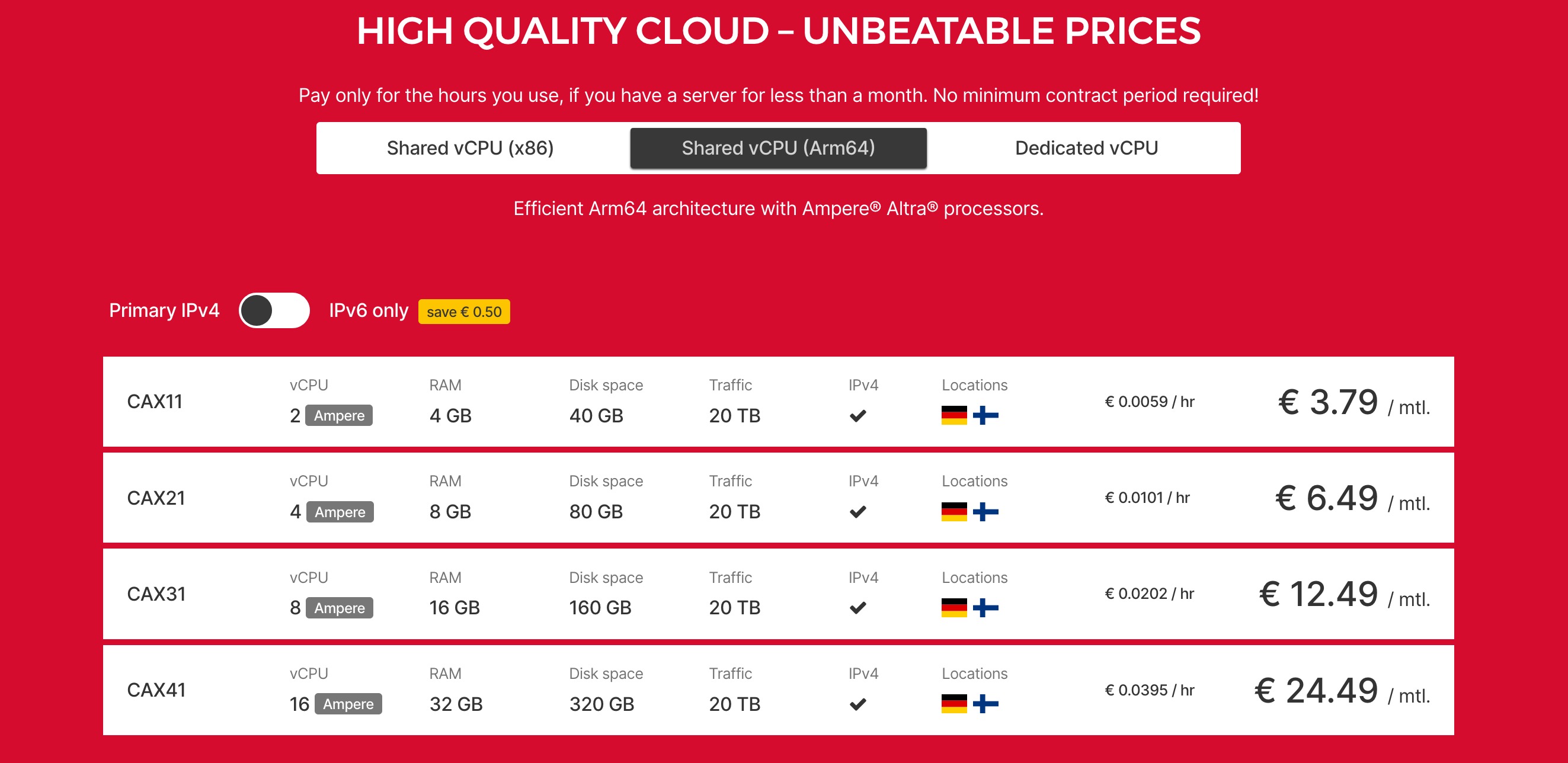

Hetzner has both Dedicated and Virtual AMPERE ARM64 servers available. CHR images are coming in next betas, currently we only release ISO for bare metal Ampere servers, such as these: https://www.newegg.com/p/pl?d=ampere+altra

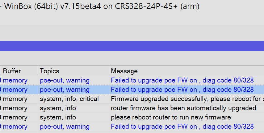

Getting POE FW upgrade fail on 7.15, had same even on 7.14 stable.
