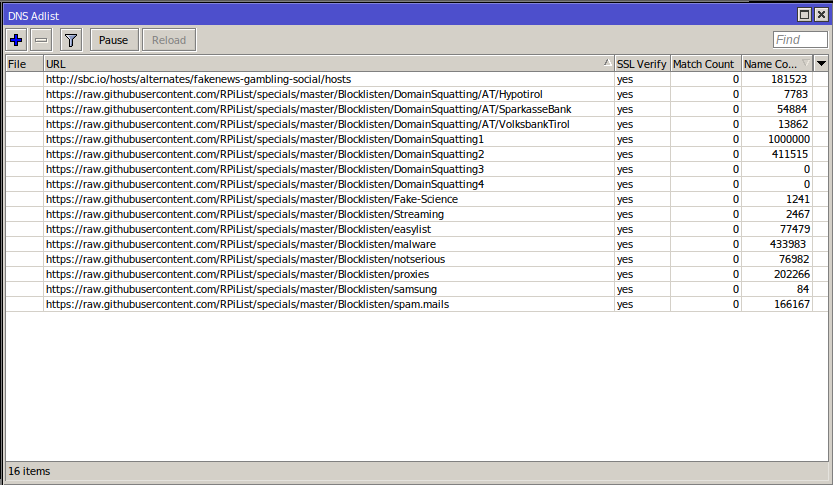

is it only for me or is the adlist feature not working correctly? There are no match counts?
Maybe it is only you that did not increase the cache size?
First, do you use doh. If you use doh, it won’t work. How big is your cache? I have about 400000 domains and for that it takes about 48 MB, so calculate how much you need.

@herbrico good to know :wink: i had doh, it works now. chatch size is set to 1.000.000 KiB.
