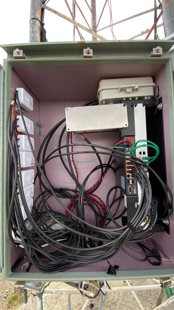

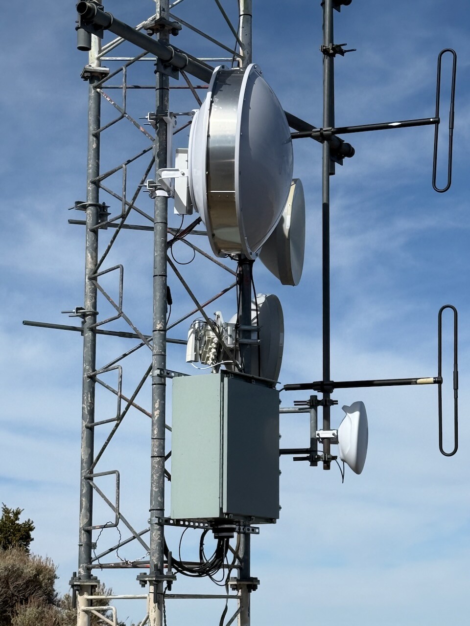

(Photos attached of a CCR2116 installed in a cabinet that is only accessible 6 months out of the year at a site that overlooks three valleys. We tried to get up there this past Monday, but the truck got stuck.)
