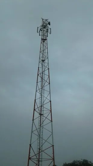

(Photos attached of a CCR2116 installed in a cabinet that is only accessible 6 months out of the year at a site that overlooks three valleys. We tried to get up there this past Monday, but the truck got stuck.)

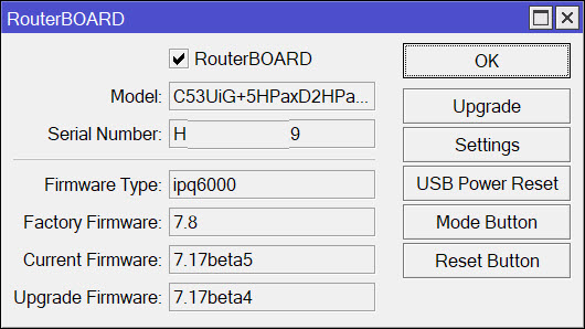

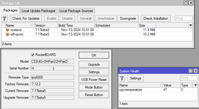

7.17beta5 seems to brick C53UiG+5HPaxD2HPaxD
Same thing with my ax3. All indicators go out and there is no link on any port and no wifi. I installed the latest beta via netinstall, then chose to restore my backup via winbox and the problem repeated. As a result, I rolled back to the 4th beta version.

My hAP ax3 also bricked when updating to beta 5. Just like with @wiktorbgu.
Resetting config it does work, but that is not acceptable, I should not need to reconfigure my device from zero. restoring the backup make the device brick again.
At the moment I’m back to 7.17b4
