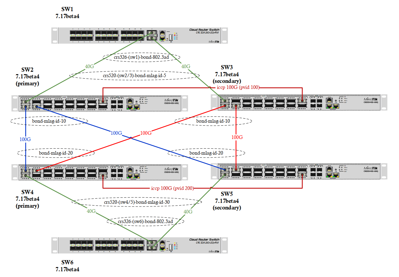

I’m not sure if this topic is entirely relevant here, but I would like to clarify what I mean when I say I hope MLAG will be fixed.
In the diagram, I’ve shown how the switches are connected, managed through a VLAN interface. SW2 and SW3 are configured in MLAG with each other, as are SW4 and SW5 (L3 hardware offloading is disabled). When any of the secondary peers restarts, everything is fine; there’s not even an interruption between SW1 and SW6, and all switch management addresses remain accessible. However, in more than 50% of cases, when one of the primary peers (SW2 or SW4) is restarted, L3 connectivity to the management VLAN of one of SW1, SW2, SW4, or SW6 is lost, requiring an additional reboot.
More on the topic is written here.
http://forum.mikrotik.com/t/mlag-bridge-not-work-in-ros-7-7-7-8-7-9-ok-in-ros-7-6/166477/1
http://forum.mikrotik.com/t/mlag-breaks-access-to-switch-half-solved/162859/1
http://forum.mikrotik.com/t/mlag-hopelessly-broken/167137/1
The same topology, but built with CRS326-24S+ switches and ROS 7.6, works without these issues. This is why I want to point out that the CRS520-4XS-16XQ-RM cannot be downgraded to 7.6 because the minimum version for this switch is 7.15.1.
