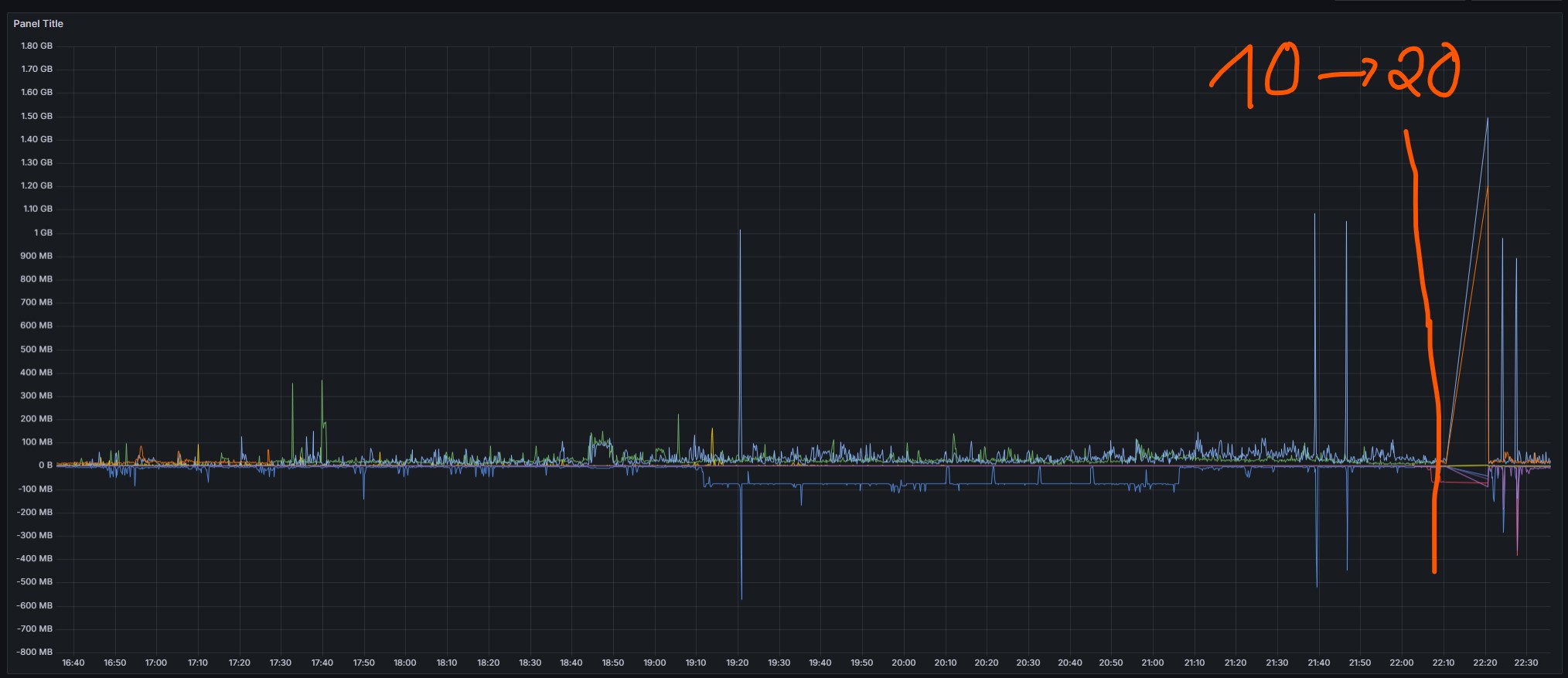

Solved the issue, but is not clear to me, why that solves the issue.
As you can see on my earlier posted route-export, i have distance 10 for my default-static-routes and distance 20 for default-route learned via BGP.
In my opinion, i guess, that a distance of 10 kicks before 20.
But in this case, that is not true.
The default-route was only used from BGP, not my static routes.
After setting static routes to distance 20, ECMP starts working.
That makes no sense to me.

OH NO ITS NOT SOLVED - ISSUE DETECTED
As long as i have Torch running on the customers interface, ECMP will work. All 4 Upstream-Interfaces are in equal use.
While having speedtest running at client side (Mikrotik Bandwith-Test) and closing TORCH on the Router, upload went back to only one upstream interface.
So there seems to be an issue with FastPath?
Disable FastPath under /ip/settings instead enables ECMP. Is this a documented behaivour?
