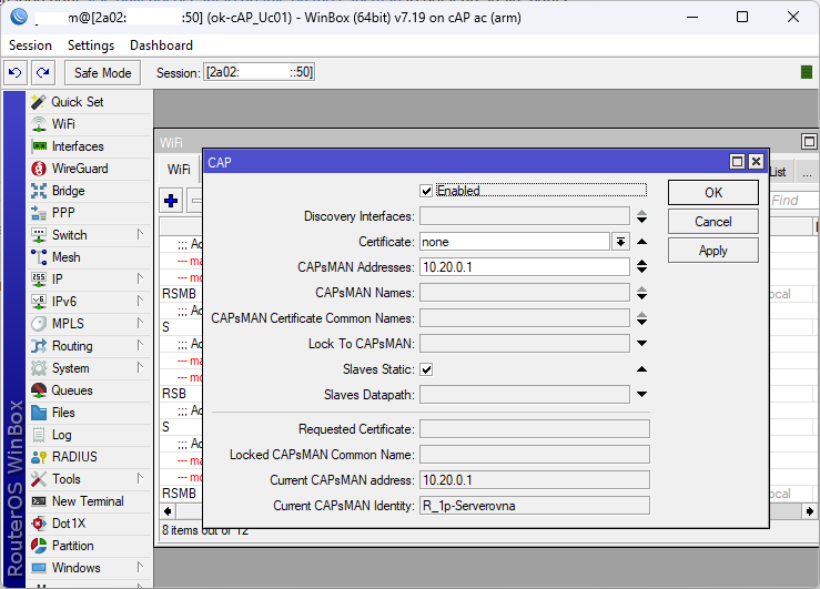

If I understood right, it is only necessary to do this on the capsman to get it up again, right?
No, every CAP needs this. (At least if it’s set up the way I understood.)
I upgraded one cAP ac to 7.19 for testing and I wonder why everything works for me… Well, after a year I found out that I didn’t set certificates until now and I’m running on “none”… it was “temporary” solution, sure :smiley:

I just consulted the documentation and honestly I do not know if my capsman uses certificates or not.
“export verbose” just gives me this:
/interface wifi capsman
set enabled=yes upgrade-policy=suggest-same-version
And the documentation is unclear. https://help.mikrotik.com/docs/spaces/ROS/pages/224559120/WiFi#WiFi-CAPsMANGlobalConfiguration
ca-certificate (auto | certificate name )	Device CA certificate, CAPsMAN server requires a certificate, certificate on CAP is optional.
But my CLI shows another possibility: “none”
So I don’t know now: if not explicitly set - does it default to “none” or to “auto”?

Of course certificates aren’t really required when you set up your home access points on a closed internal network…
