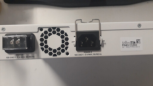

This is less probable problem with dual-PSU devices, but similar situation has been observed when Mikrotik's cheap-*ss 24V power brick "almost fails". More than one access point had to be revived by netinstall because "repeating-brownout-while-booting" messes device up to unbootable state. These power bricks are one of weakest points of Mikrotik hardware as they tend to fail more often than other equipment. If Mikrotik device (fed by this power brick) is offline after power outage, then first thing to check is the power brick and more than once it turns out to be the cause.
Maybe your issue is caused by using the wrong export format.
You should use "/export show-sensitive" or at most "/export terse show-sensitive", NOT "/export verbose".
Doing so will cause problems like the one you mention.
That is true. I would not say that they fail more frequently than similar power bricks from other manufacturerers, but for sure they fail more frequently than the routers.
Every time when we had an issue at some site (router no longer working), it always turned out to be a defective power brick and replacing it fixed the issue.
True,

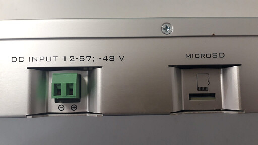

in fact, most CCRs that have "dual" power, I replace one with "direct" battery power.
Those that have only one, remove it and power it directly from the batteries (no PoE, right on the internal connector).
Straight DC input can be handy if appropriate DC power is available. That's why RB1100AHx4 has separate DC 24 - 57V input connector in addition to 2 AC inputs. It might be a good idea for other devices to have it as well probably...
Maybe they'd put them everywhere...
±24V and ±48V... (better leave 48>24 V conversion OUT of the board...)

The problem with providing 48V input is that the users expect it to be isolated because they feed it with -48V, so it cannot be the usual diode wired-or that is used on the low-end models.
There has to be an isolated powersupply converting 48V to something else (probably 24V) and then it can be wired-or into the DC line that is again downconverted to 5V, 3.3V etc.
Have that on all models would introduce extra cost, and also the chance of failure of that module is about the same as for a 100-240V supply.
