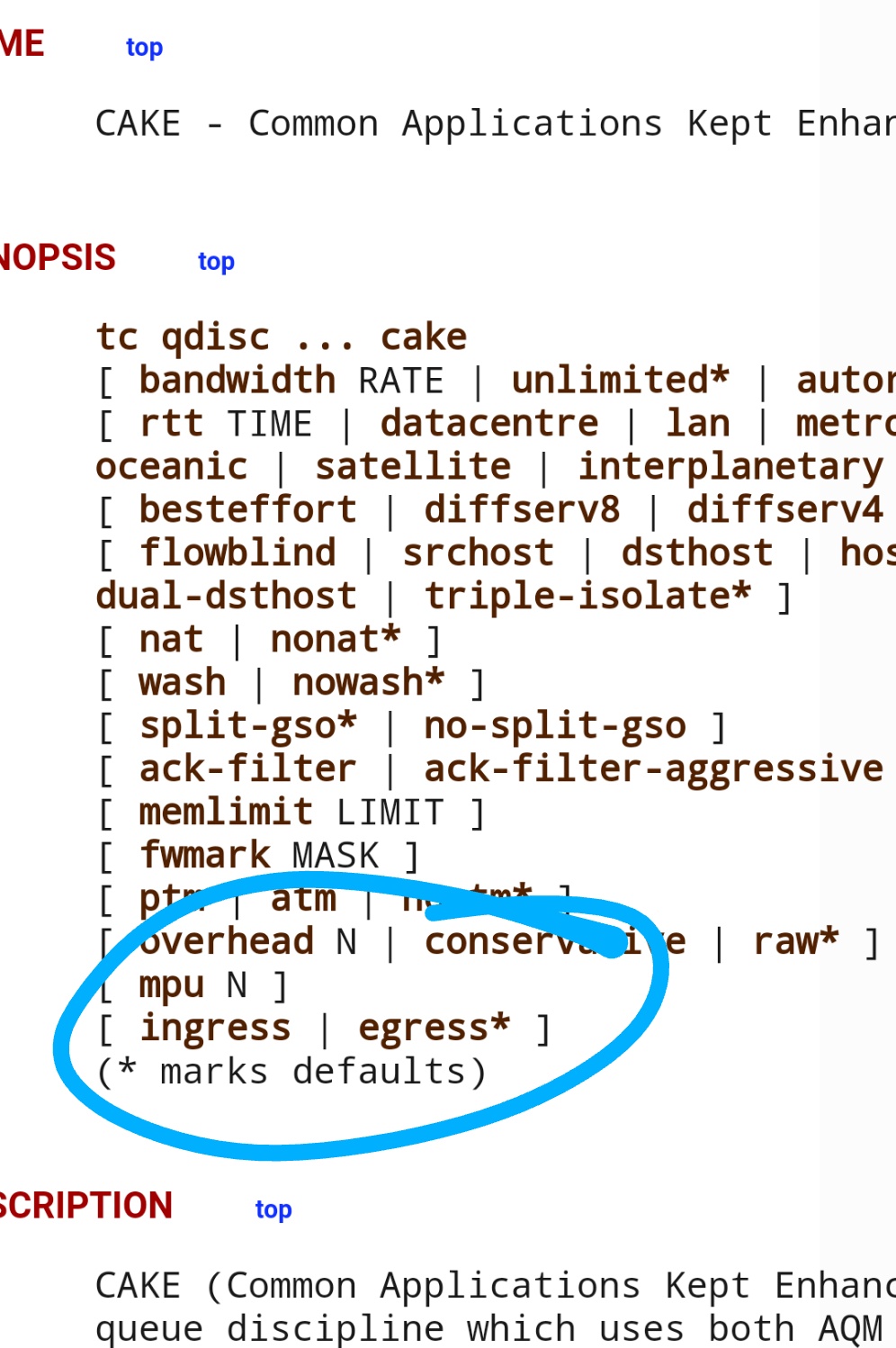

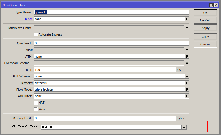

Hey MikroTik, how to use the cake-autorate-ingress flag of cake? cake qdisc defaults to egress according to linux docs. No way to tell it, that it is ingress instead. So if you set cake-bandwidth to 50mbit and enable autoingress: it works for some minutes to finally reduce to 1mbit approx. I assume it is due to the missing possibility to set ingress/egress. Cake wont autorate on egress and finally autorates something very low.

I opened SUP-59224 with this suggestion:
would make sense.
see also synopsis https://man7.org/linux/man-pages/man8/tc-cake.8.html
