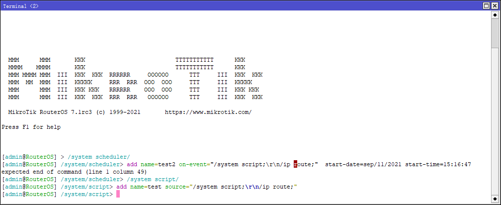

It seems that can’t add scheduler via cli if the on-event contains the char of '', but it’s ok for script:
If you create that in Winbox and then do an export, you get this:
/system scheduler add name=test2 on-event="/system script;\r\
\n/ip route;\r\
\n" policy=ftp,reboot,read,write,policy,test,password,sniff,sensitive,romon start-date=sep/11/2021 start-time=11:42:24
which is weird and doesn’t import from the CLI.
Interesting too that export still uses spaces rather than ‘/’ as the delimiter in the command.
One might have expected it would say “/system/scheduler/add …”.
