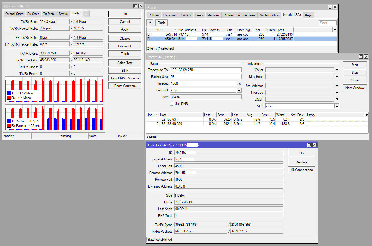

And ipsec hardware acceleration for arm and arm64 was added in 7.1rc5 and if you’ve experienced issues with older builds(?) also, your issue is very less likely to be related to hardware acceleration since it was all done in software up to that point.
And I have a tunnel currently working fine since some time now on arm64 (RB5009) with 7.1rc7, other end is arm 6.47.10 (hAP ac2). No drops.
Probably worth debugging the issue a little more on your end.
