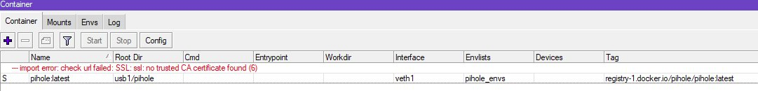

There’s some problem with certificate / containers leading pulling from docker.io impossible.
I’ve seen those problem after downgrade from v721b2 (which also resulted in inability for container to run, so i’ve decided to simply repull them)
Personally i’ve fixed this with /certificate/settings/set builtin-trust-anchors=trusted but today I’ve seen other people with this problem (they trying to use containers for a first time)

That’s because docker decided to go with Let’s Encrypt CA authority. Previously is was production.cloudflare.docker.com certificate. So, if you want to use SSL certifcate with container pulls. You need to use the builtin-trust-anchors or import them manually to your certificate store.
There was also a docker certificate with a large list of Subject Alt. Names which was revoked and no longer being renewed. I no longer have it since I deleted it.

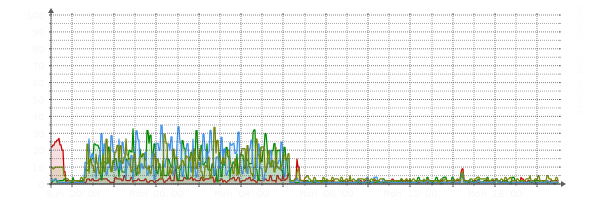

IPsec still has some hiccups. ~once a day the router goes into a state where the tunnel constantly restarts phase2 negotiation. policy disable -> enable fixes it for some time.

Had some similar symptoms with 7.20.0.
This shows the cpu load. starting at 20:00 it got into the looping state, in the morning a policy reset fixes it. For now…

We have same problem and device, but with ROS 7.19.6. Do you see any significant RAM usage? Can you share your RAM graphs too?
Ram graph is dead flat @400m since forever.
