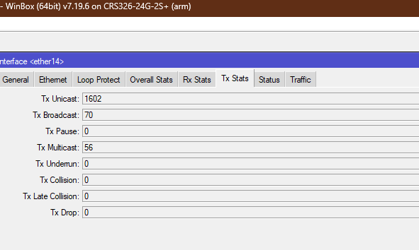

on firmware 7.19.6 TX Stats looks ok

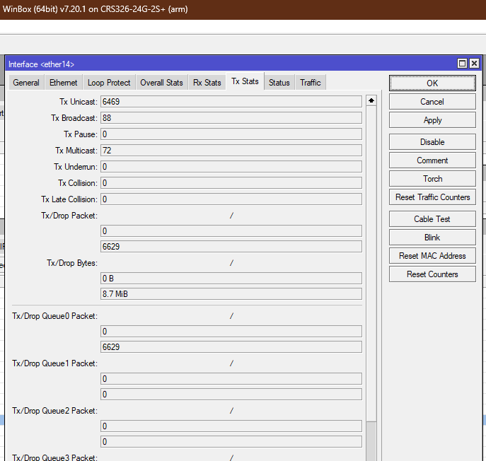

and on 7.20.1 i get this weird display
Currently, there are a few issues with Tx Stats, which are related to the following change introduced in version 7.20:
  • switch - rework ethernet counters for 98DXxxxx, 98PX1012 and CRS1xx/2xx switches (add tx-drop-queueX-byte/packet, tx-drop-byte/packet, tx-queueX-byte to /in/eth and updated GUI);
The issue you saw is caused by a limitation in WinBox v3. It should display correctly in the latest WinBox 4.0beta35.
Another issue is that devices which do not support per-queue counters still show empty values in the GUI. This will be fixed in version 7.20.2.
All these are GUI-related issues.

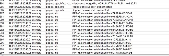

7.20.1 presents the same problem with PPPoE for mass authentication of clients, you have to disable the vlans and wait for the goodwill to upload the PPPoE clients
Support file sent!!

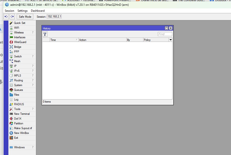

I didn't see if it was reported yet, but the system history from Winbox isn't working, it shows a blank screen, from the console it shows the history without problems.
Confirmed (and it's already with 7.20) but ... on 7.21b2 and 7.21b3 it does show (tested on RB5009).
So that bug most likely will also be ported forward ?
