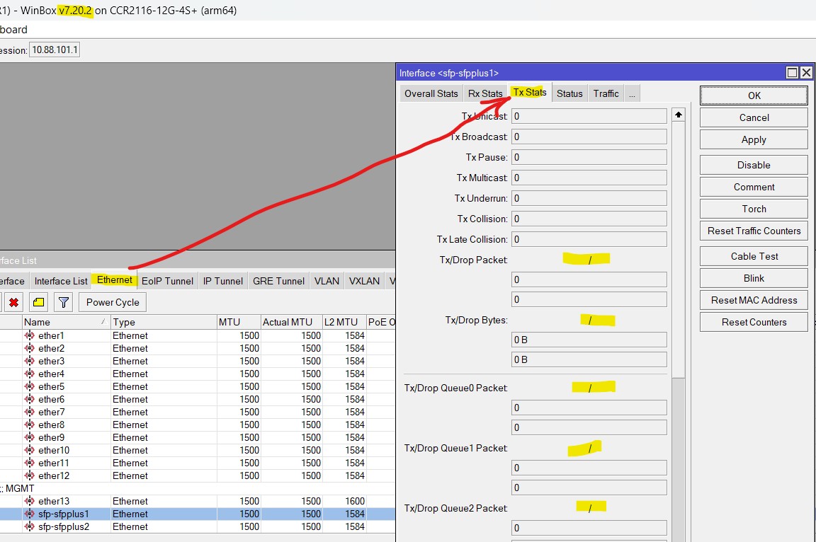

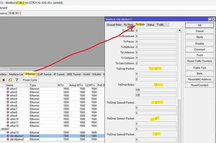

winbox - fixed Ethernet Tx Stats (introduced in v7.20);
not convinced…

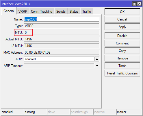

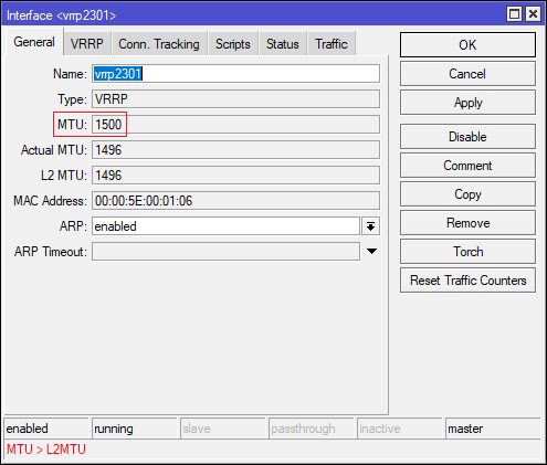

In 7.20.2, the MTU value for a VRRP interface created on a VLAN interface created on a Bonding interface is set to 0, and after a system reboot, the MTU value is set to the same as that of the parent Bonding interface (in my case, 1500). As a result, the "MTU > L2MTU" warning for the VRRP interface appears after a reboot.

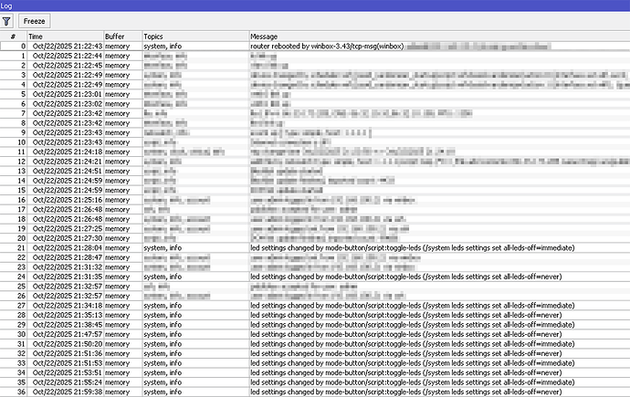

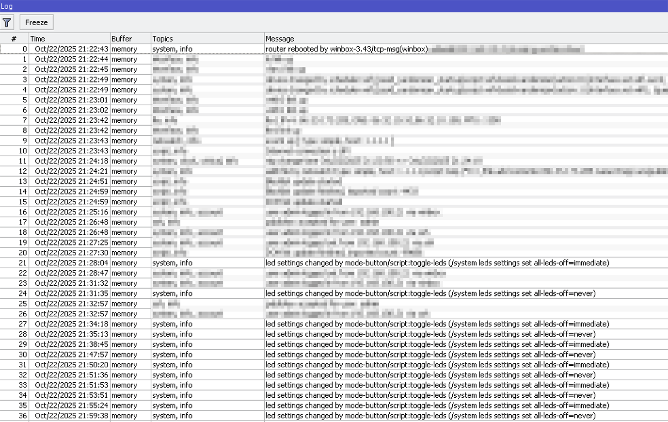

Issue with WPS button event is not resolved with this update mentioned in my 7.20.1 topic post
Noticed also that issue is not occurring if button event is disabled prior boot and then enabled again when booted (event is working on button press), so I think this excludes HW issue.
