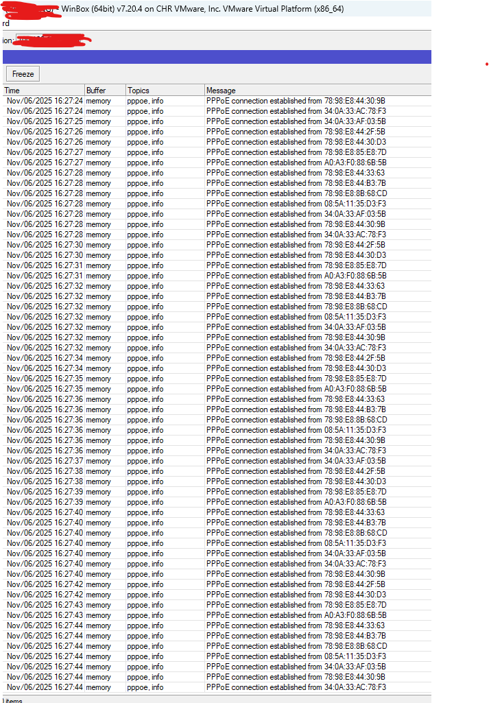

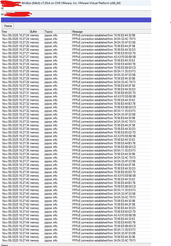

Please check (SUP-203163)
7.20.4 still have problem with this issue
Are you sure ? what about this ? PPPOE over VLAN is not fixed.
after downgrade to 7.19.6 all users connected
Thanks for feedback, please share supout.rif to support@mikrotik.com.

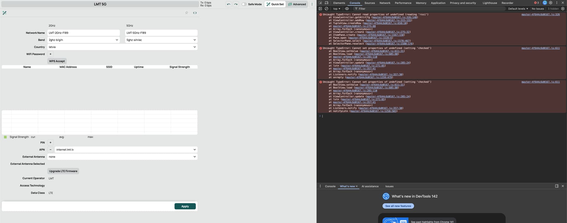

I tried to update my CRS312-4C+8XG-RM from 7.20.2, everything went smoothly but after reboot, web UI was from 75% broken, I couldn’t use QuickSet page, couldn’t check for RouterOS updates etc. In Chrome developer console I could see some strange error messages containg strings “master” (git?) etc. Fortunately WebFig files and packages pages were working so I managed to downgrade back to 7.20.2. Then I tried again to upgrade to 7.20.4 but unfortunately with the same result. Any one else with the same experience?
Thanks for reporting, issue confirmed!
It's quite noticeable that since the redesign and partial rework, WebFig keeps running into JavaScript errors that make the interface completely unusable. These errors can always be seen in the browser console.
I would really expect MikroTik to learn from this. It's very easy to catch such issues in a CI pipeline using a headless browser - even without complex tests. Just something like "visit WebFig, check if there are console errors." That shouldn’t be a problem in 2025 with modern infrastructure, should it?
Agreed. With things such as Selenium you can easily automate browser actions through code.

/webfig/#Quick_Set broken on LMT 5G - JS errors and broken UI
Uncaught TypeError: Cannot read properties of undefined (reading 'rssi')
/webfig/#Interfaces.Interface.8 ( interfaces>lte1 ) - js errors as well
Uncaught TypeError: Cannot read properties of undefined (reading 'sinr')
master-4f644c6d0167.js:326 Uncaught TypeError: Cannot read properties of undefined (reading 'rssi')
    at ViewController.getAttrCfg (master-4f644c6d0167.js:326:140)
    at ViewController.addRow (master-4f644c6d0167.js:315:155)
    at TupleView.createRow (master-4f644c6d0167.js:658:10)
    at master-4f644c6d0167.js:275:88
    at Array.forEach (<anonymous>)
    at ViewController.create (master-4f644c6d0167.js:275:32)
    at ItemPane.create (master-4f644c6d0167.js:1567:150)
    at Pane.open (master-4f644c6d0167.js:1539:6)
    at SelectorPane.select (master-4f644c6d0167.js:1578:467)
    at SelectorPane.reselect (master-4f644c6d0167.js:1580:176)
master-4f644c6d0167.js:611 Uncaught TypeError: Cannot set properties of undefined (setting 'checked')
    at BoolView.setValue (master-4f644c6d0167.js:611:31)
    at BoolView.load (master-4f644c6d0167.js:605:80)
    at master-4f644c6d0167.js:285:110
    at ViewController.update (master-4f644c6d0167.js:285:24)
    at lstn (master-4f644c6d0167.js:271:85)
    at master-4f644c6d0167.js:357:41
    at Listeners.notify (master-4f644c6d0167.js:357:30)
    at onreply (master-4f644c6d0167.js:1259:479)
