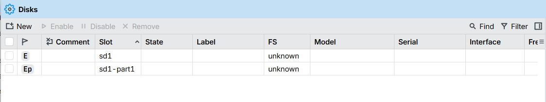

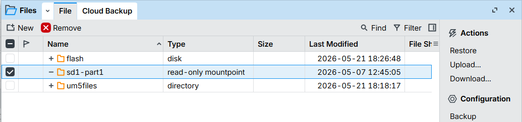

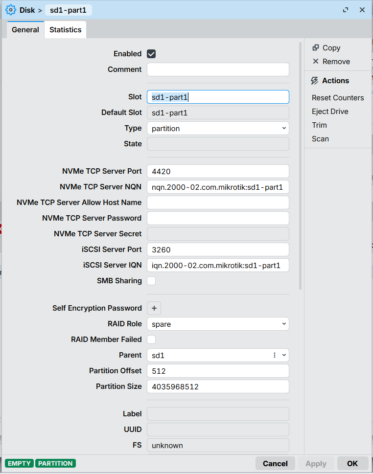

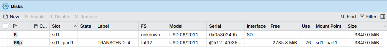

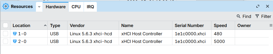

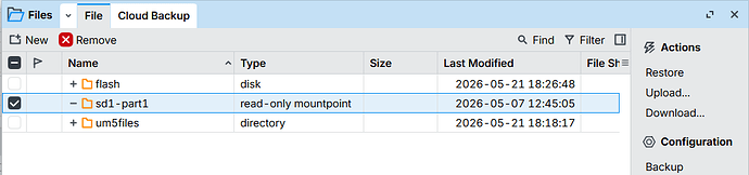

I've updated hEX from 7.20.8 to 7.22.3 and lost access to the MicroSD card
EDIT:
After a few reboots of the router the SD card is back:
