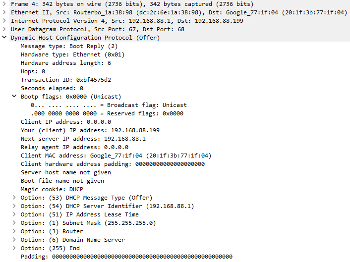

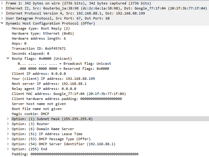

Regarding the Nest cam issue when upgrading to 7.3.x, this is what I found:
The DHCP Offer has re-ordered options compared to 7.2.x.
7.2.1 DHCP Offer:
7.3.1 DHCP Offer:
You will notice that the options are now in numerically sorted order in 7.3.x, which dhcpcd-5.5.6 (which is in use on Nest hardware, and clearly a ludicrously old version) does not seem to support.
@stroebs: if you find a standard (RFC) which requires particular ordering of options inside DHCP offer, then you can file bug report with MT. If you don’t find it (quite likely), then … I’m sorry, mate.
