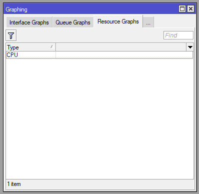

Progress, but you still have work to do. Memory usage and Disk usage gives: ERROR: NO ACCESS!
CPU usage is fine and interfaces.
While you are at it fix mikrotik_logo.png on WebFig. Please make background transparent and not white.
EDIT: the hardware is hAP ac² and is added image where only CPU is present

Hardware used: hAP ac²
After trying several times to install 6.44.6, activate the graphs, have them recorded, then update to 7.5,
and repeat the process with 6.46.8 and 6.48.6, I was unable to duplicate the problem.
All the times the graphs worked perfectly.
Probably is a problem on your filesystem, and since you don’t give a damn about contacting technical support(*) , I’ts your problem.
(*) On removed useless posts, the user do not want provide supout.rif to technical support at support@mikrotik.com
What is the problem???
