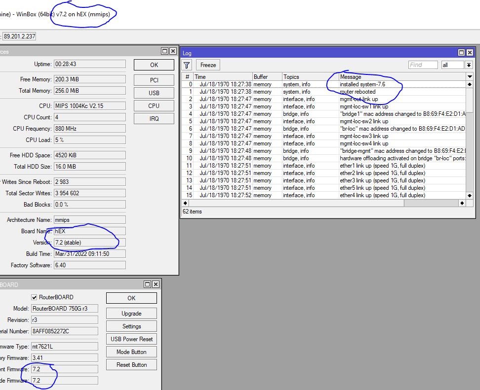

updated hex from 7.2 to 7.6 but version remains the same
I have the same problem
You’ve updated RouterOS but not Routerboard, please follow https://www.youtube.com/watch?v=WPW3mHlEzn4
You’ve posted on the forum without understanding the post you mention, please view https://forum.mikrotik.com/download/file.php?id=56334
