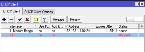

after upgrade to 7.8rc1 USB LTE can’t get DHCP client. showing status stopped

Same here with Alcatel IK41 USB LTE modem on hAP ac2.
I have downgraded ROS to 7.7 to make it work again.

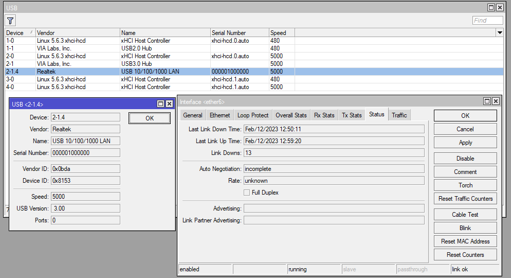

USB Gb ethernet adapter (Techole UH411) with Realtek RTL8153 not working properly. Stats tabs are empty, no autonegotiation. Tested on hap ax3 and hap ac, adapter working on linux and win. machine without problem.
