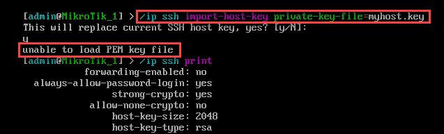

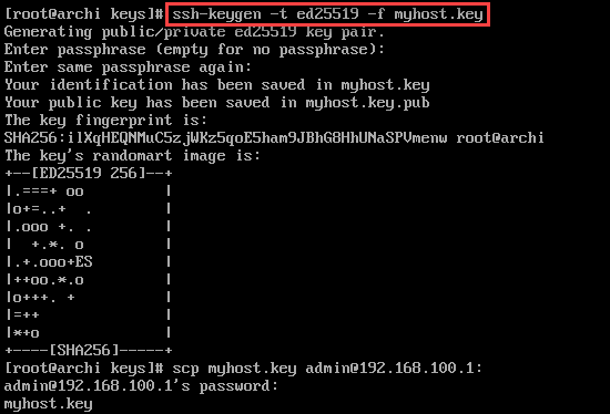

*) ssh - added Ed25519 host key support;
Tried this, but importing an ed25519 hostkey on 7.9 beta4 (x86 CHR Image) does not work, see images how i generated the key and tried to import it
Also tried a RFC4716 converted key file, but this one also refuses to import
ssh-keygen -e -f myhost.key >myrfc4716.key
RSA works as normal, so what’s the change here??
Regards @colinardo
As I wrote above… This is not (yet) about public key authentication. You now have the choice to use RSA or ed25519 host keys. You can see what host key type is used in the heading of randomart Image.
I know, but this is the host key, i tried to import the hostkey for the router itself not for a user.
Impressive amount of work done here, regardless if what anyone specifically wanted didnt get done. The paperwork alone is not trivial, just imagine the testing and integration involved. Kudos to the dev team and test team.
Ahh found it, you have to set the key-type first:
/ip/ssh
set host-key-type=ed25519
regenerate-host-key
But custom host keys in ed25519 format still will not import via import-host-key command after changing the setting above.
