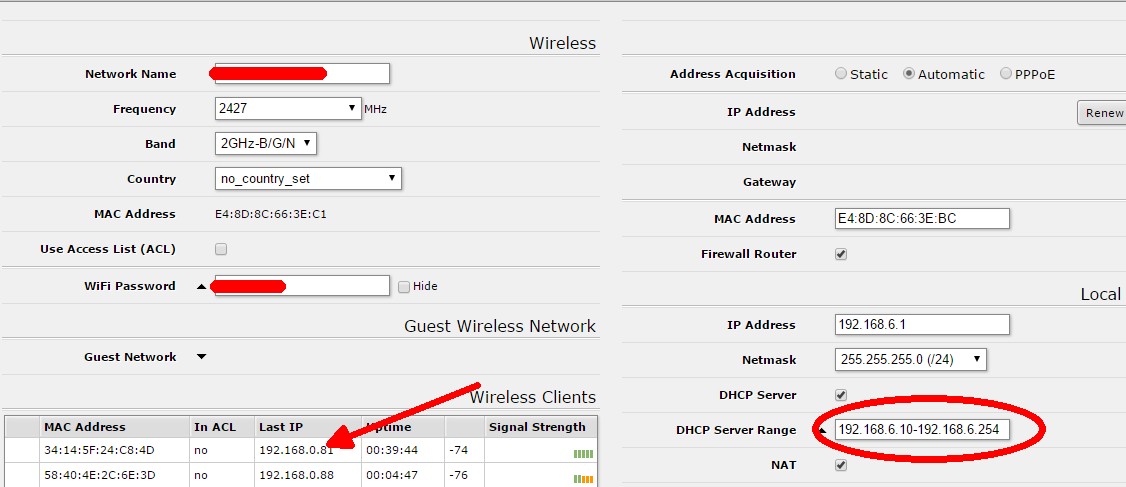

Confusing to me, but perhaps there’s an easy solution. Take a look at the screenshot. There is no DHCP configuration that would allocate the IP addresses shown in the circle for the wireless connection, and you can see the IP scheme to the right. The same faulty 0.XX scheme also pops up sometimes with wired connections, not just wireless. I need to get this resolved as quickly as possible. What details do I need to give to be able to figure this out?

Last IP in registration table doesn’t mean that there are actual problem on the router. Last ip is ip address found in the last IP packet received from the registered client.

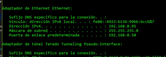

Here is the shot from ipconfig/all. The DHCP server is listed as a device on the 6.XXX network, but how could it assign IP addresses, and why would it assign 0.XXX addresses?
The authoritative DHCP server is 192.168.6.150 which is not your router. As a general rule: ANY device can hand out IP addresses.

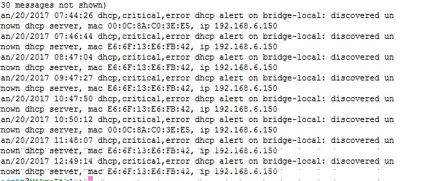

This isn’t exactly anything we didn’t already know, but I find it interesting that there are 2 devices that are registering as DHCP servers. Since the MT recognizes them as DHCP servers, is there no way to configure the MT to always act as the priority DHCP server, even if other servers are found? Is there any importance to the fact that the IP being assigned is always X.150, regardless of the MAC ID?
