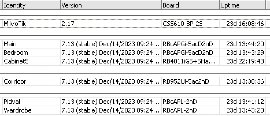

My setup - RB4011iGS+5HacQ2HnD as main router (RSTP 6000) - have 2 WANs, CAPsMAN manages all Caps I have, 2 x RBcAPGi-5acD2nD (Cap AC) (RSTP 9000), CSS610-8P-2S+ to poe some devices and 2 Caps (RSTP 8800), 2 x RBcAPL-2nD (Cap lite) (RSTP 9000), RB952Ui-5ac2nD (RSTP 9000). No VLANs, around 200 devices connected via ethernet or WiFi, most via 2.4GHz. Have several Firewall and NAT rules to block most ports and manage fail-over of 2 WANs, some devices have priority to one of the WAN all other to another WAN. Attached is config of main router, other have default settings.

they all using older wireless package or the new wifi package?
also some configuration would be useful to see
Yes - they all have new wireless package as separate one, updated to 7.13.

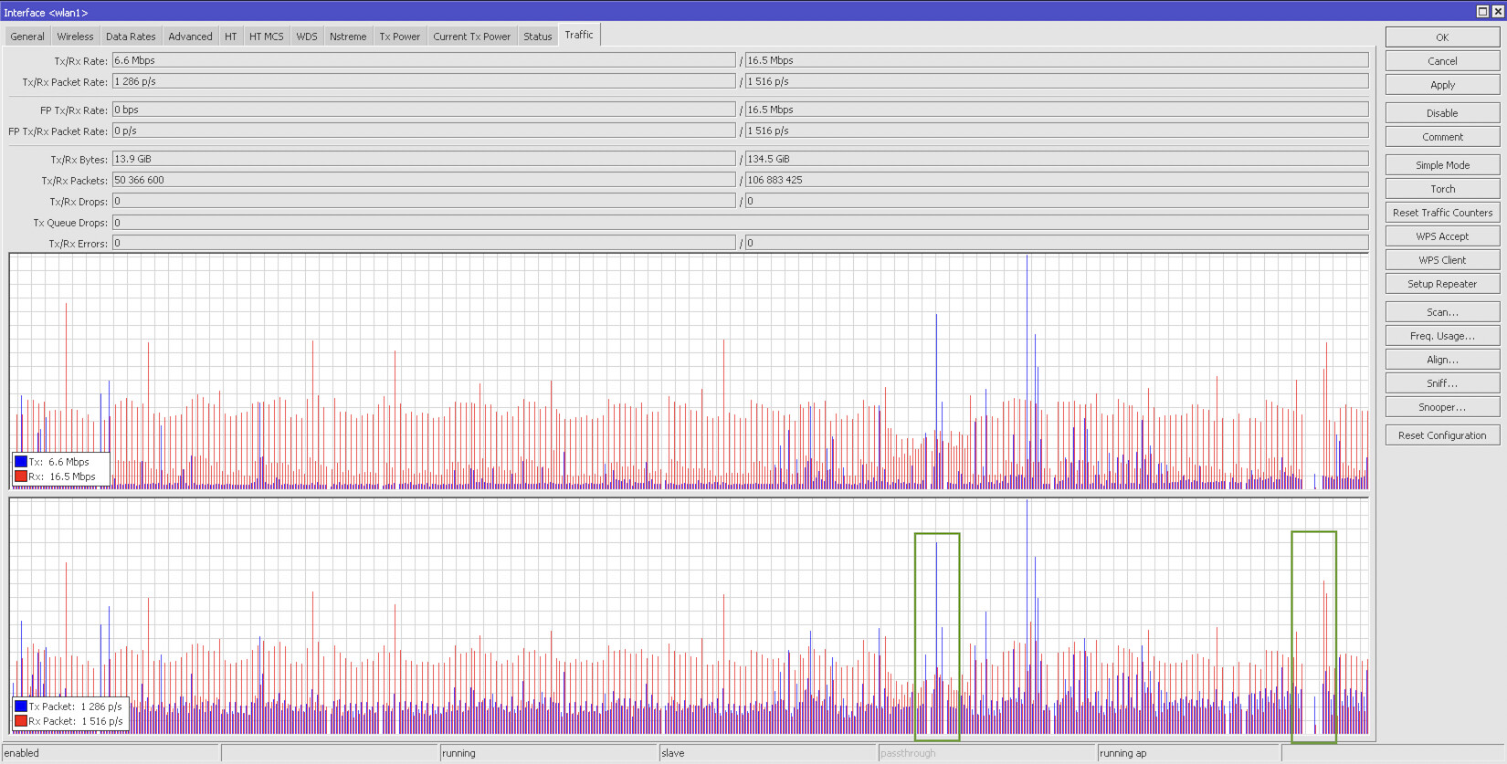

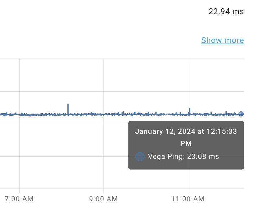

Another laptop is connected via WiFi and see hangs during a calls. At same time I do ‘pings’ and traffic monitoring from WiFi-connected laptop - traffic hangs for same time as during a call and shows ‘gaps’ in graphic - see attached images

As @gotsprings already written “[it is] a wifi issue”. You have not given any information about the hardware of your laptops using Microsoft Windows. However by your description and Intel’s Advanced Intel® Wireless Adapter Settings page, the issue is at hand could be related to either of the following settings:
  • Global BG scan blocking
By default, the Wi-Fi adapter will perform periodic scan for other available Access Points (AP).
Disabling this behavior can be helpful when using application software that is sensitive to brief interruptions in network connectivity. > [emphasis added]
  • Always> : Will not perform periodic scans for other available APs.
    • Never (default)> : Will perform periodic scans for other available APs.
    • On Good RSSI> : Will only perform periodic scans for other available APs when the current AP’s signal strength is low.
The default setting may causes the issues like the one you are experiencing. Either select On Good RSSI or Always - the former is the safer bet if you are using your devices at other locations too.

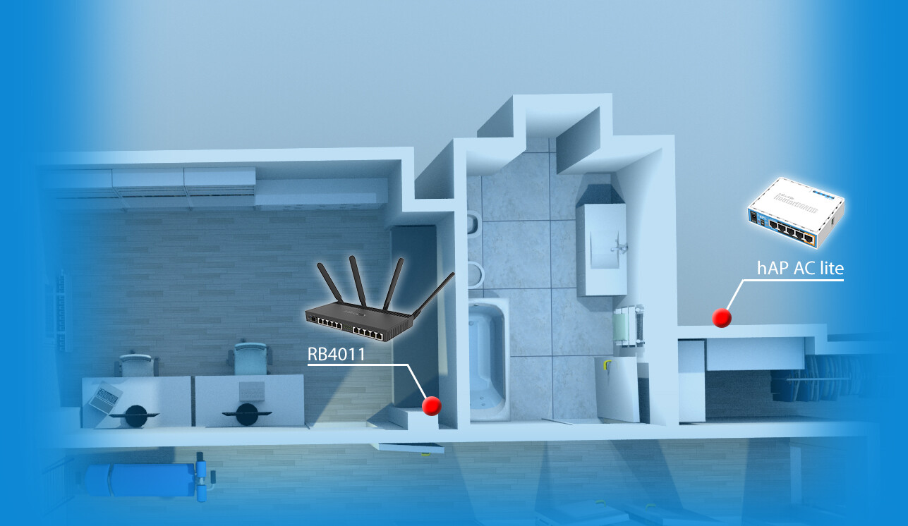

There was a bottleneck in one of my configurations - hAP AC lite (RB952Ui-5ac2nD) was connected via 5GHz WiFi to RB4011. Placement is shown at this picture. Between them there are 2 brick walls. hAP AC lite has RTSP 4k camera connected that constantly sends traffic.
During monitoring I’ve found that “Tx/Rx CCQ” is on average 60% with quite often drops to 20-30%. At place of hAP there is quite crowded place from neighbors. So my first test was to switch WiFi bridge to use 2GHz instead of 5GHz. Then I changed channel width to 20MHz and CCQ increased to 70% with drops to 40%. During those drops if there 1 or more calls at same time there were some short ‘hungs’ of traffic flow (monitored it on separate PC via LAN connection) for 0.1-2 seconds. I assume there is some ‘bug’ in processing of breaking radio connection and traffic on RB4011 that produces ‘deadlock’ in queue processing as at same time sometimes there were ‘spike’ of CPU usage from 3-4% average to 20%.
As I have old RB2011 laying around I added it as dedicated WiFi bridge. Now RB2011 connected to RB4011 via LAN cable on 1Gb ports. On RB2011 nv2 bridge configured. On hAP AC lite nv2 station WDS configured to connect to RB2011. Both use 20MHz channel width and less crowded 2GHz frequence 2432. On this setup I see Tx/Rx CCQ on average 85% with drops to 65%.

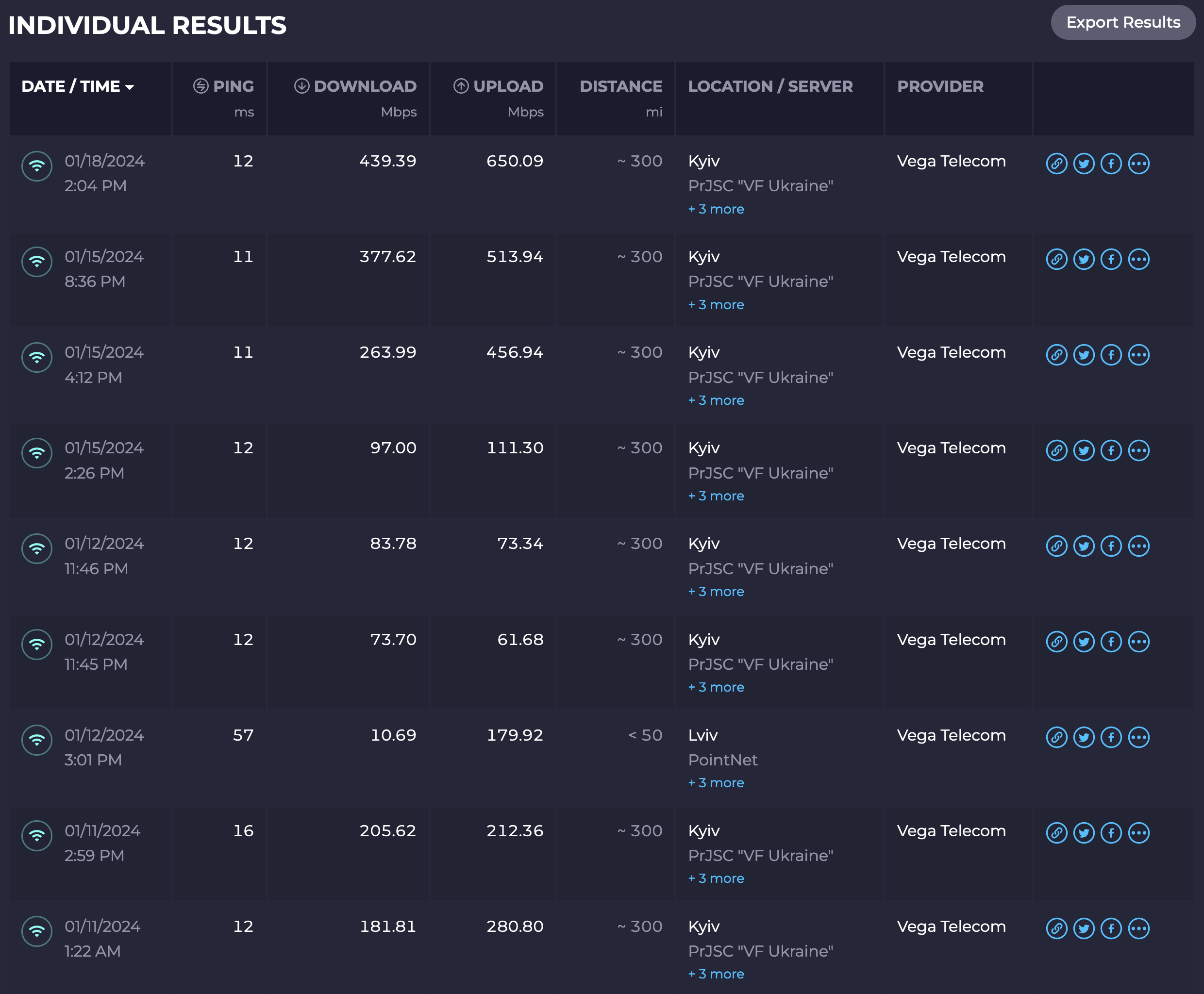

Last 3 days WiFi is stable 100% + speed is increased significally.
My guess is still the same - WiFi bridge on RB4011<->hAP was unstable due to 2 brick walls - it received incomplete/corrupted packets that leads to deadlocks/crashes of queues processing and ‘hungs’ of the processing thread that produced interruptions of existing clients connections. Taking this to separate hardware RB2011<->hAP fixed issue.
