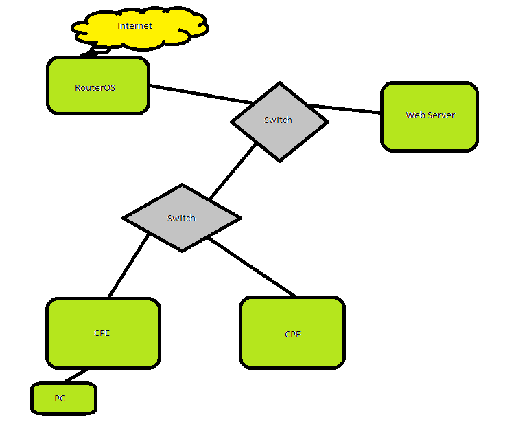

Tell me if if my understanding is correct, I need one webserver for each CPE/client?
thanks boen_robot
No.
Just one server that’s “behind” your router, on EQUAL ground with all CPEs, like this:
this is my actual and simplified netword map:

Basically, use a switch which is NOT a “smart” one. If you want to be 100% sure, use a “Hub” instead of “Switch”, since a “Hub” is by design always “mirror”-ing traffic.
To “mirror” basically means to send the traffic to all of the switch’s ports, as opposed to just the designated one. Many switches maintain a list of MAC addresses and a corresponding port the MAC is supposed to respond from. When a packet is intended for one already in the list, they send it only over its port, and not on other ones. That is, unless the device doesn’t respond in a certain time interval, at which point they send it over all ports again. This is good for performance, bad for capturing traffic.
Some smart switches have the ability (via a web interface or whatever) to turn off this feature for a particular MAC address. If you can’t find a hub, your best bet is one such switch, on which you can blacklist your router’s private facing interface, so that messages intended for the router always reach the server also.
As far as your topology goes - attach it to the “switch” in your diagram.
