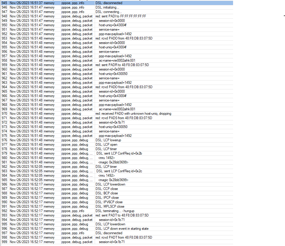

this is all i can see in the logs:
As the PADI/PADO/PADR/PADS handshake completes successfully the PPPoE session should work, but there is no response to the LCP negotiation.
I would suggest connecting the modem directly to a PC/Mac and configuring a PPPoE client on that to verify a connection can be established, if that also fails then it would be a case for Draytek support.
Thanks for you support, just found the solution:
Vlan7 was configured on the Vigor130, that works fine until 3.8.4. After 3.8.4.1 its not working anymore. I removed the vlan tagging on the Draytek Vigor and added the vlan 7 to my mikrotik interface. That solved the problem.
