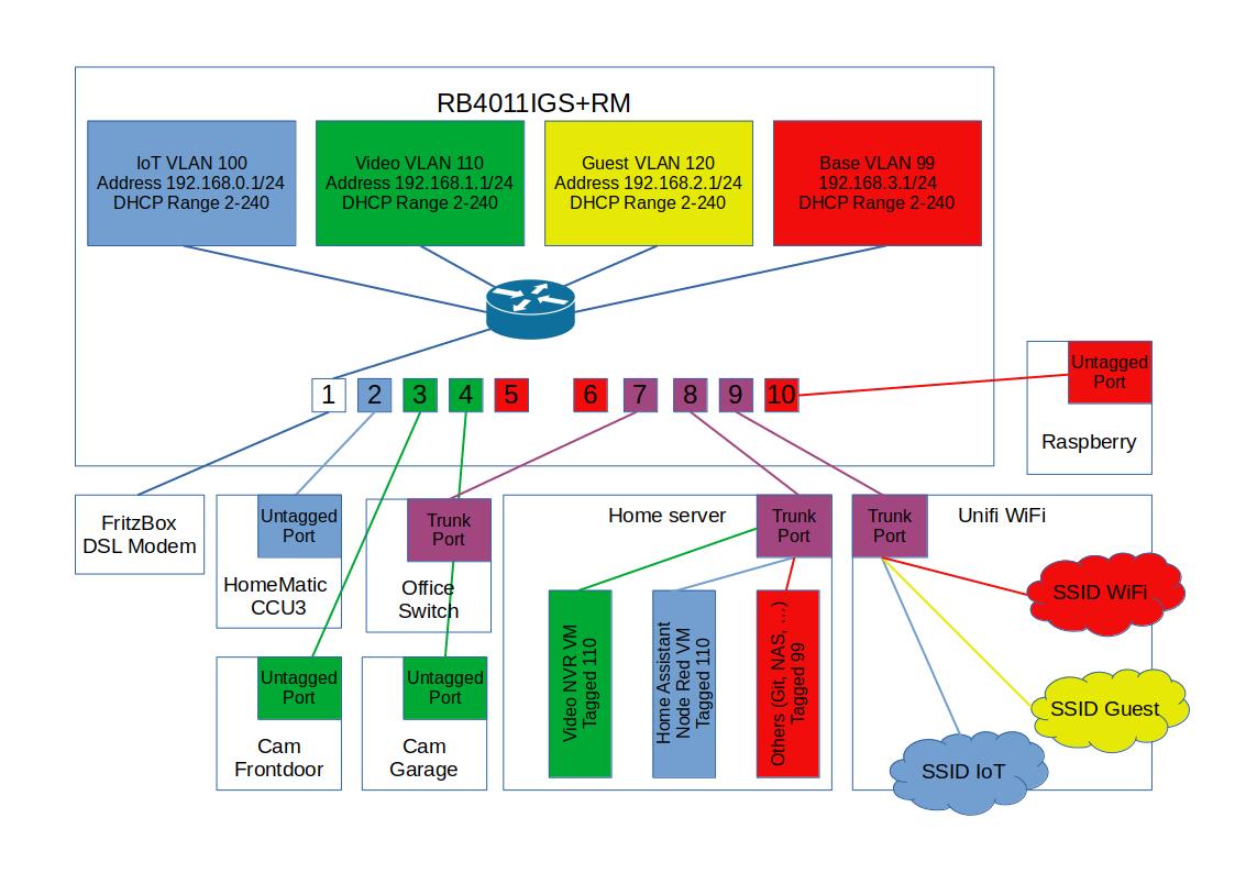

Hi everyone,
after days of reading how-tos (e.g. http://forum.mikrotik.com/t/using-routeros-to-vlan-your-network/126489/1 and many others) and struggling with the configuration I head to you and ask for help.
Attached you can find a diagram of the network I want to achieve and an rsc file with the configuration my latest configuration. Running firmware 6.49.
  • WAN on ether1
  • Some access ports (cameras, Raspberry, SmartHome)
  • Some trunk ports (for WiFi, Switch to other room, and server)
  • The WiFi controller will add VLAN tags based on the SSID.
In the end some of the networks should have internet access and communication between VLANs should be restricted. But for now I’d be happy if every device would have internet connection and free routing between all VLANs.
How I tried to configure the device:
  • Factory reset with button
  • Connect with winbox
  • Remove default configuration
  • Open terminal in Winbox and execute the lines in the rsc file
I tried to change a lot of small details but in the end I was always locked out after the last step (activate vlan-filtering)
/interface bridge set bridge1 vlan-filtering=yes
On the access ports DHCP is not responding. Manually configuring an IP matching the network on the corresponding port didn’t help.
On my linux machine I setup VLAN 99 (MGMT vlan) and tried to connect on a trunk port. Without success.
sudo ip link add link enp37s0 name enp37s0.99 type vlan id 99
sudo ip addr change 192.168.30.242/24 brd 192.168.30.255 dev enp37s0.99
sudo ifconfig enp37s0.99 up
192.168.30.1 unreachable.
When using the trunk port wireshark showed that the packets were tagged (802.1Q ID99) but even the ARP request are not answered by the router.
Mikrotiks seem to be very powerful but I underestimated how steep the learning curve is. Quite frustrating.
MyMikrotik.rsc (7.47 KB)

Config Review
(1) Problem number one, I hate reviewing configs in that stilted and incomplete format you have used, vice the natural format of
/export hide-sensitive file=anynameyouwish,
(2) Your firmware is out of date, recommend the latest LONG TERM version of firmware.
(3) (wrong) FROM
/interface bridge vlan
add bridge=bridge1 untagged=ether2,ether3,ether4,ether10 vlan-ids=100,110,110,99
set bridge=bridge1 tagged=bridge1,ether7,ether8,ether9 [find vlan-ids=100]
set bridge=bridge1 tagged=bridge1,ether7,ether8,ether9 [find vlan-ids=110]
set bridge=bridge1 tagged=bridge1,ether7,ether8,ether9 [find vlan-ids=120]
set bridge=bridge1 tagged=bridge1,ether7,ether8,ether9 [find vlan-ids=99]
TO
set bridge=bridge1 tagged=bridge1,ether7,ether8,ether9 untagged=ether2 vlan-ids=100
set bridge=bridge1 tagged=bridge1,ether7,ether8,ether9 untagged=ether3,ether4 vlan-ids=110
set bridge=bridge1 tagged=bridge1,ether9 vlan-ids=120
set bridge=bridge1 tagged=bridge1,ether7,ether8,ether9 untagged=ether6,ether10 vlan-ids=99
Notes:
-I removed ether5 from vlan99 as this will be a non-port emerg access to the router ether5emerg-access
-All smart devices should get an IP address from the management LAN.
-Only ether9, needs vlan120 going through it.

Thanks for the extensive review.
First of all: In general it’s now working and I can go on going into details. Trunk ports are fine and on the access ports DHCP is giving me an IP depending on the VLAN of the access port. Thanks!
Regarding your points
(1) TBH Still new to the whole stuff. Different formats are confusing to me but I’ll use the export in the future.
(2) Whats the benefit of using the long-term (6.48.5) compared to the stable (6.49) I’m using?
(3) I guess that was the main reason why nothing was working as expected before. I’ll definitely add the emergency interface to ether5 or 6. Good point.
(4) I’ll get into details of the firewall in my next configuration steps and double check everything. But thanks for the hint!
(5) Thanks…missed to add MGMT_VLAN to the VLAN list. Totally makes sense.

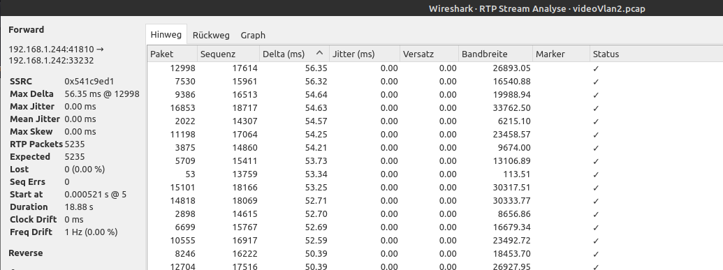

  1. Artefacts in RTSP Video streams from IP cameras
  • Two IP cameras with static IPs (192.168.1.243, 192.168.1.244) on mikrotik port 6 and 7
  • NVR (AgentDVR) running in Docker container with ipvlan driver (192.168.1.242) on server on mikrotik port 8
    The cameras and NVR were already running for month on my old router (FritzBox 7590) without any issues. Since using the Mikrotik video is breaking up when looking at the live stream.
    Recordings downloaded and played back using VLC locally are also a total mess.
On NVR server side the only thing that has changed is that ipvlan driver is now used on the server because the container should be in the video VLAN 110 and of course the router :wink:.
If google results didn’t trick me the layer ipvlan adds should be pretty thin and usually does not cause trouble.
On Mikrotik side I tried some things:
  • Changing ports (before that cameras and server were not on the same switch chip)
  • Checked MTU (1500 on mikrotik and server, cameras have no option to show/change the value)
  • Set bridge STP mode from none to MSTP (read the recommendation and thought it shouldn’t be wrong even if theoretically loops etc. shouldn’t be an issue here)
  • Set flow control (tx/rx) “on” for all involved ports
  • Upgrading to testing firmware 7.1 (hoped to get HW offloading but it is still shown as off)
  • Capturing stream with wireshark to analyze it (packet sniffer, streaming to my PC running wireshark. No data from cameras. Probably because it is not passing the CPU?)
  • Capture the video stream on the NVR server with tshark. Analysis of the RTP stream showed some high delta values around 50ms. Struggling to get what that means? High latency?
The rest of the network is rock-stable and I could not see any packet-loss or high latency. The next best thing that comes to my mind is QoS. But is that really required on a 1Gbit link where nearly no other data is transferred and video streams consume something like 10 Mbit. When streaming directly from the cameras to VLC on my PC in MGMT network it is working perfectly fine even though routing is involved. So I’d guess it must be related to the NVR server or the server port.
docker-compose.txt (1.16 KB)

Regarding the second problem (just for better understanding):
Next step would be configuring a switch with VLAN support (e.g. I have a Unifi Flex Mini) like this:
  1. Port (uplink to Mikrotik)
  2. Port Access Port Video VLAN for camera 1
  3. Port Access Port Video VLAN for camera 2
  4. Port Trunk Port for server (NVR sets Video VLAN tags on it’s own)
In that case the packets between Cameras and Server should not need to pass the Mikrotik and would simply be passed between Port 2, 3 and 4 by the switch right?
If the problems disappear there is something wrong with my Mikrotik configuration or firmware. Otherwise somewhere else (cameras, cabling, server).
Your description/scenario is not clear.
I dont have a visual on what vlans are going to what ports on the unifi and mikrotik, a mini network diagram would help.
Assuming the vlans come from the Mikrotik there are two cases.
a. mikrotik is a switch in which case its pretty much transparent
b. mikrotik is a router in which case traffic goes tot he router everytime a firewall rule needs to get matched that affects that vlan.
I tried to bypass the router by connecting cameras and server on a managed switch with an uplink to the Mikrotik Router. This way I could rule out that the Mikrotik is the root of evil :wink:
The video streaming artefacts also appear when data is only passing the managed switch.
The switch ports have been set to “Access Port VLAN 110 (video)”. All other ports are transparent. Video NVR server has interface in VLAN 110.
To be absolutely sure data is not going through the router I removed the uplink.
I guess the problem won’t be the cameras because the stream directly from camera to VLC on PC is working fine. Maybe it has something to do with the docker ipvlan interface used to have a tagged network interface in the video VLAN.
Maybe I’ll just try to treat my server with a second network card and configure an access port in VLAN 110 for the video server :wink:
Id get rid of the UNIFI (and get any other managed switch) or set it up as a NORMAL managed switch where all VLANS go to it are TRUNKED on port 1.
In any case, if you insist …
The RB4011 setup for port 8 would look like
/interface bridge ports
bridge=bridge interface=ether8 ingress-filtering=yes pvid=99
/interface bridge vlans
bridge=bridge tagged=bridge untagged=ether8 vlan-ids=99
bridge=bridge tagged=bridge,ether8,ether6,ether7 vlan-ids=110
bridge=bridge tagged=bridge,ether8,ether4,ether3 vlan-ids=100
Notes: The unifi should have an IP address on the subnet of vlan99.
Hybrid Port8 Carries both 110 and 100 to the unifi for onward use.
Thx anav. This configuration was just for testing purposes. As the video stream problems persist I’ll get rid the unifi switch between the components.
At least the Mikrotik router is doing just fine and the root cause must be somewhere else.
And yes I’ve already noticed limitations on the Unifi Flex Mini switches. You can’t configure custom port profiles. Your only options for each port are “Access Port” or “Untagged (all VLANs allowed)”. So no hybrid port configuration possible on the “small” Unifi switch. If I need more I’ll think about a RB260GS.
I have a couple of those and they work well.
The video streaming problems are fixed! The streaming protocol was set to “auto” which is (for AgentDVR) UDP. After switching to TCP the problems are gone.
I can happily live with that but wonder what the reason is? Wrong order or lost packets that are corrected by the TCP protocol?
