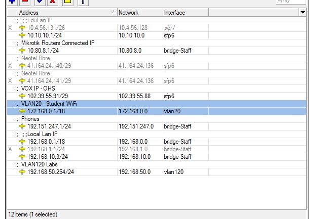

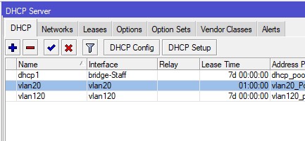

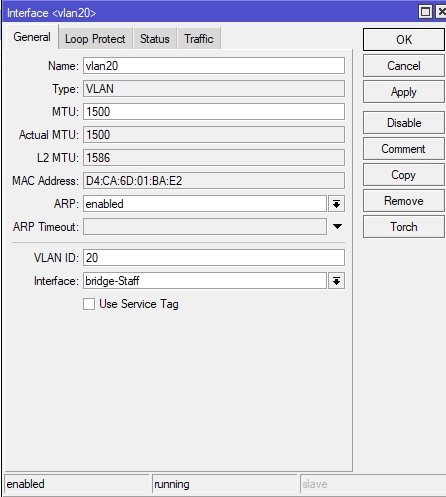

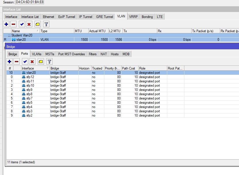

For some reason my VLAN dhcp is not going through to my client WLAN, it used to work but something went wrong and I cannot locate the problem. My apologies for my config that looks a bit messy, but over the last year a lot has changed. Basically my main router has dhcp for my admin network, then we added the VLAN for students. The dhcp is refusing to work. Any help would be appreciated.

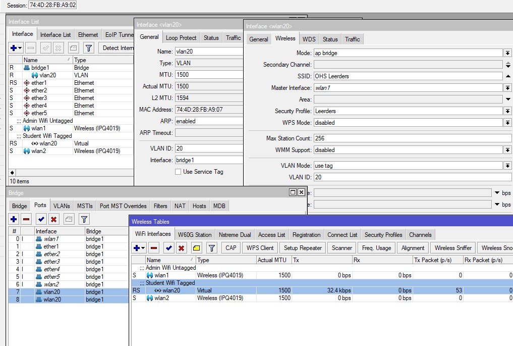

Here is some of my config. The first 4 images are my main router. The last one is ONE of the AP’s. I have 20 of these that need to work.
Since you didn’t post full configuration, only a few screenshots, we can only guess. You can post full config: execute /export hide-sensitive from terminal window and copy-paste the output.
Other than that: I guess vlan20 interface should not be member of bridge bridge-Staff.

Thank you for the reply. Here is the export. I removed the VLAN from the bridge but still no change.

add address=10.80.8.1/24 comment="Mikrotik Routers Connected IP" interface=bridge-Staff network=10.80.8.0
add address=192.168.0.1/18 comment=";;;;Local Lan IP" interface=bridge-Staff network=192.168.0.0
add address=172.168.0.1/18 comment="VLAN20 - Student WiFi" interface=vlan20 network=172.168.0.0
add address=192.168.50.254/24 comment="VLAN120 Labs" interface=vlan120 network=192.168.50.0
add address=192.151.247.1/24 comment=Phones interface=bridge-Staff network=192.151.247.0
add address=192.168.10.3/24 interface=bridge-Staff network=192.168.10.0
add address=102.39.55.91/29 comment="VOX IP - OHS" interface=sfp6 network=102.39.55.88
add address=10.10.10.1/24 interface=sfp6 network=10.10.10.0

/ip dhcp-server config
set store-leases-disk=10m

add address=172.168.0.0/18 comment=Koshuise dns-server=172.168.0.1,10.80.8.1 gateway=172.168.0.1 ntp-server=172.168.0.1
add address=192.151.247.0/24 dhcp-option=Phones dhcp-option-set=Phones_set1 dns-server=192.151.247.1 gateway=192.151.247.1
add address=192.168.0.0/18 comment=Admin dns-server=192.168.0.13,192.168.0.3 domain=kwagga.local gateway=192.168.0.1 netmask=18 ntp-server=192.168.0.1
add address=192.168.50.0/24 comment=Labs dns-server=192.168.50.1 domain=outeniqua.co.za gateway=192.168.50.254

You have set the bridge to be VLAN-aware but not configured any bridge VLANs, so no tagged traffic will pass through the bridge. See https://wiki.mikrotik.com/wiki/Manual:Interface/Bridge#Bridge_VLAN_Filtering
I read through that wiki, I’m sorry I still don’s know what I am missing. Please be more specific. I am not good with VLAN’s yet. Thank you in advance.
You need to specify which tagged VLANs are made available to the various bridge ports, including the bridge itself as a bridge has two roles - a switch-like role for transporting packets between ports, and a port-like role for transporting packets between the bridge and other functions provided by the Mikrotik.
So
/interface bridge vlan
add name=bridge-Staff tagged=bridge-Staff,sfpX,sfpX,… vlan-ids=20
with the appropriate interfaces which should present VLAN 20.
The AP will need configuring similarly.

If a bridge has vlan-filtering=yes only untagged traffic will pass through the bridge ports. However, if vlan-filtering=no the bridge behaves similarly to an unmanaged switch so any VLAN tagged traffic will pass through all bridge ports.

Setting this:
add arp=proxy-arp mtu=1500 name=bridge-Staff priority=0x1000 vlan-filtering=yes
as seen in your export.
Is enabling VLAN filtering. This requires the proper setting of the VLAN table and all VLAN setting as explained by TDW, because the VLAN traffic is filtered according these settings.
Removing and rebuilding the bridge will give you a bridge with vlan-filtering=no (the default setting) and then the vlan20 will reach the WLAN20 again, because there is no filtering.
With vlan-filtering=no all VLAN information in the bridge setup is ignored, VLAN packets are handled like untagged packets. VLAN tagging at the WLAN interface works independently.
This is one (the first one) of the 3 ways to handle VLAN’s.
  1. dump-switch/bridge no filtering (vlan-filtering=no)
  2. Switch defined filtering and handling (ethernet ports only)
  3. Bridge defined VLAN filtering and handling (vlan-filtering=yes)
