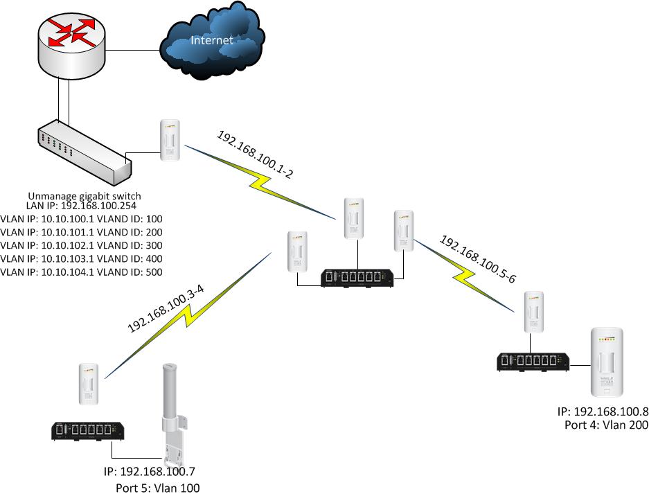

Guys, can you tell me what is wrong with my setup. LAN ip is working with internet but VLAN has no internet and cant get ip from VLAN dhcp.
if this config is wrong, can you help me fix it.
thanks in advance.

The diagram isn’t labeled very well, but I will assume that your vlan interfaces are on the WiFi interface of the device attached to the unmanaged switch?
You probably don’t need those masquerade rules. One should do:
add action=masquerade chain=srcnat out-interface=WAN
If your clients aren’t getting DHCP addresses you have to look at your vlan setups on all the devices. You didn’t post that info here. DHCP is layer 2 only and if you’re using vlans it’s likely the setup isn’t right on the other devices.

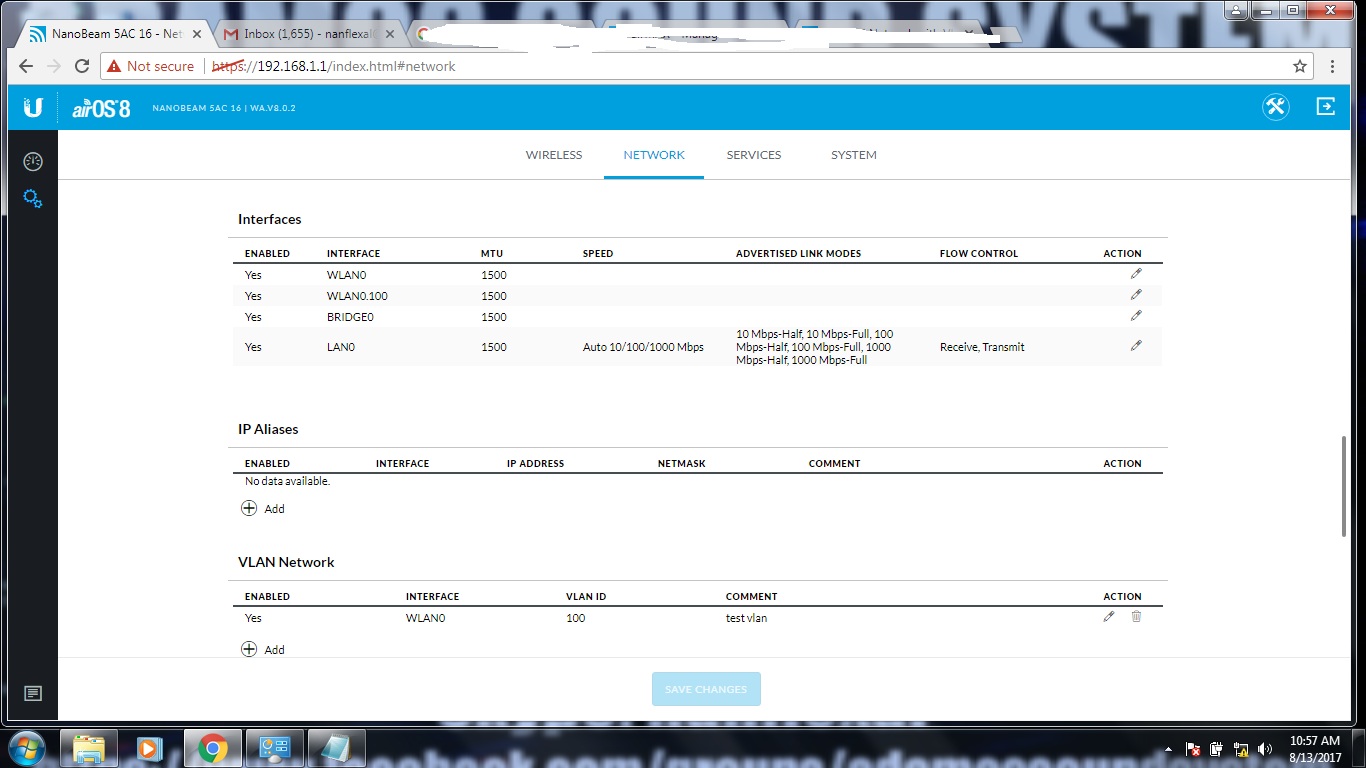

hi guys
i setup small router at home without toughtswitch & i use un-manage switch and still my VLAN is not working and cannot receive ip from VLAN dhcp.
nanobeam is in router mode with vlan enable connected to litebeam ac sector. libtebeam ac sector has no vlan tag and in bridge mode.
You’ve got the wrong forum it seems.
maybe but my router is miktrotik.
if you play just with MT, you will fix the problem.
I always put my radios in WDS (Transparent Bridge) mode and keep the network as Bridge not routed.
