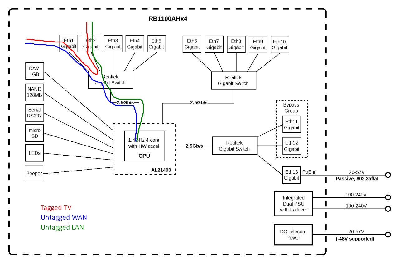

I am not sure what you read, but to do what you want to do should be possible by using a bridge port for the WAN connection. v7.8 claims to support the RTL8367
switch chip for hardware bridge offloading. See https://help.mikrotik.com/docs/display/ROS/Switch+Chip+Features footnote 3.
3 Bridge HW vlan-filtering was added in the RouterOS 7.1rc1 (for RTL8367) and 7.1rc5 (for MT7621) versions. The switch does not support other ether-type 0x88a8 or 0x9100 (only 0x8100 is supported) and no tag-stacking. Using these features will disable HW offload.

I am not sure if the RB1100 supports HW bridging when you are bridging multiple switch chips all in the same bridge. It would seem the CPU would be required for bridging any traffic between the switch chips.

I also read “Layer 2 misconfiguration” chapter from MT help and found out that 3 switch chips will provide an additional challenge with bridge VLAN filtering. Found that out the hard way and read later of course…
My main trouble is/was how to make RB1100Ahx4 to route the internet traffic and bridge VLAN4 at the same time.

So my initial idea is:
  1. create a bridge also for WAN interface and attach WAN ethernet port to it. (HW offloading should be disabled for that bridge to allow another ports of the same switch chip to be added to LAN bridge with HW offloading)
  2. create 2 VLAN4 interfaces. One interface on LAN bridge and one on WAN bridge
  3. create a 3rd bridge and bind those two VLAN interfaces with that bridge
Then apply correct VLAN filtering to bridges.
Am I totally going to wrong direction with my thoughts here?
Why not single VLAN aware bridge with VLANs properly configured?
That would be indeed nicer but I fail to understand how can I bridge VLAN4 that comes in from ISP on WAN side to LAN with one bridge and have all untagged traffic routed at the same time.
The way I would approach is one bridge. No vlan 4 interface, you don’t want the connection to the “routing engine” for the TV vlan.
Something like (not tested) (this is “internal wiring” only, firewall, interface lists, etc. not covered here). You will need to add ip addresses to the LAN_vlan213 (and WAN_vlan666 will get its ip via DHCP from the ISP)
vlan 4 IPTV (connected tagged to ether1 and ether2, no connection to bridge (CPU/routing_engine) - note: there is no vlan interace associated with vlan 4, it is only configured for the bridge ports ether1 and ether2
vlan 666 internet (connected Untagged to ether1, tagged to bridge (CPU/routing_engine) There is also a vlan interface WAN_vlan666 associated with this vlan, it’s the “connection” to the routing engine.
vlan 213 LAN (connected Untagged to ether2, tagged to bridge (CPU/routing_engine) There is also a vlan interface LAN_vlan213 associated with this vlan, it’s the “connection” to the routing engine.

If you haven't started work, and possibly locked yourself out, I would suggest configuring one of the ether ports on a different switch chip to do your configuration from. At a minimum the port you are working on should not be a member of the bridge that is associated with the RTL8367 that ether1-ether5 are connected to.
I also don't know how the default config configures multi-switch devices, e.g. whether all ports except the WAN are configured into on bridge (and a single broadcast domain in a single 192.168.88.0/24 subnet) or it if does something different.
The important point is to do the configuration from an ether port that is not configured as part of the bridge you are working on, especially if you are not intimately familiar with how the device works, and have the ability to use tagged interfaces from a vlan-aware device.
