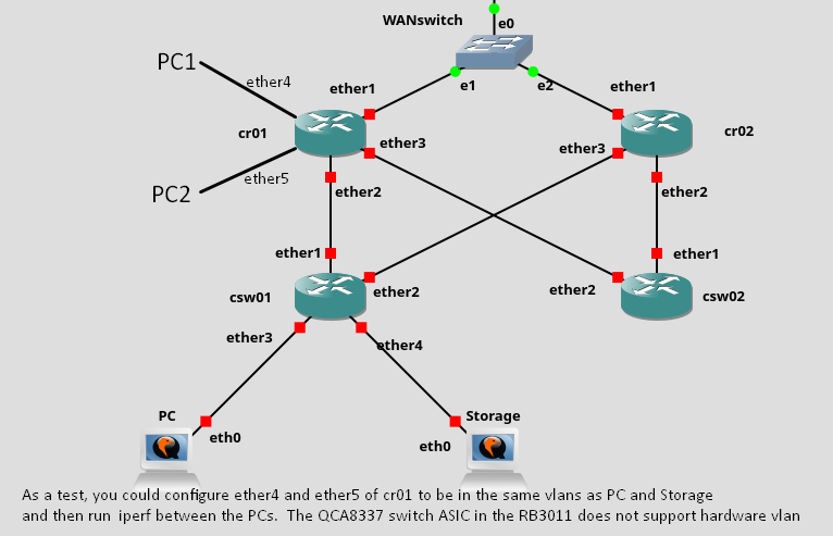

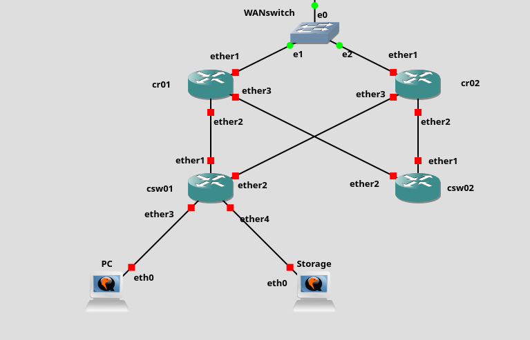

Please see the image below for a stripped version - the redundant cabling for the devices are still missing.

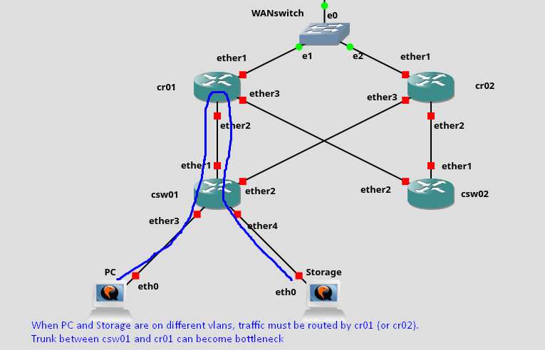

But the reason that inter-vlan traffic is slower is because it has to be routed and go through the firewall. Stuff within the same vlan can be switched in the hardware switch ASIC. For example in @derdeagle’s main diagram, if both the PC and Media server were on the same vlan, traffic between them would never even go across the trunk like to the RB3011, it would all happen at L2 in the CRS326.
Even if a more powerful router replaced the RB3011, inter-vlan traffic would still be limited to 1Gbps aggregate. This is because the trunk link between the RB3011 and CRS326 has to carry the traffic both ways, so a uni-directional 1Gbps flow between the media server and the PC would saturate both directions in the trunk link. This is discussed in post #13 of the Slow handover between vlans thread.

It may be that you are using vlan filtering on the RB3011 and ROS does not support the QCA8337 switch ASIC for vlan-filtering, even in v7. In this respect, even MT7621A in the RB750Gr3 has better ROS support for vlans than the RB3011. See Bridge Hardware Offloading for what I mean.
The lack of vlan-filtering support should only make intra-vlan communication on the RB3011 slower. If you have to route between vlans anyway, the CPU is already going to be in the path, so whether there is vlan-filtering support or not will not make much difference.
The all intra-vlan traffic between ports on the RB3011 will be limited by the CPU on the RB3011 (and probably by one core).
I would expect that even if you configured ether4 and ether5 on the RB3011 to be in the same vlan, you would get worse performance than if you had two ports of the CRS326 in the same vlan.
Here are the paths the traffic would take if you use different vlans
