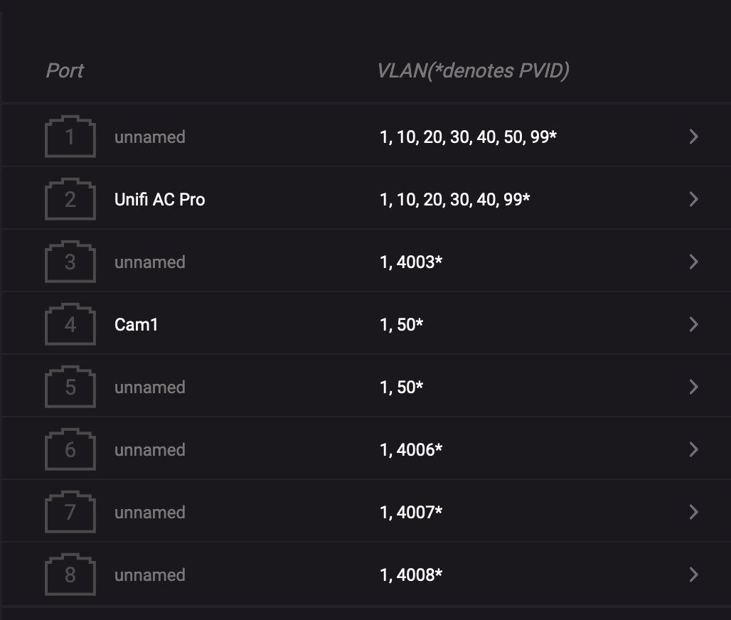

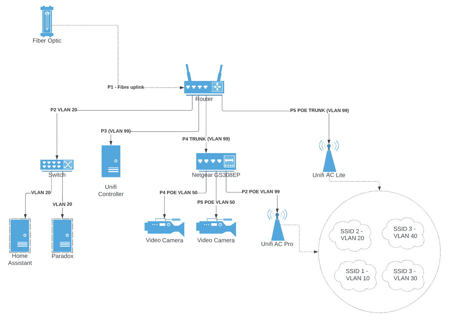

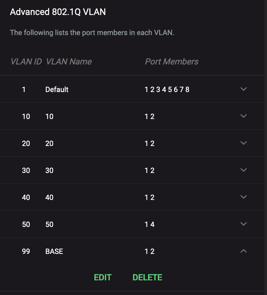

I’m stuck - I’m running a home network with a few different VLANs. Up to this point, the set up was fairly simple (although I still needed to get help from this forum to get it running). A hAP AC with with two Unifi ACs and a dumb switch. I am now adding a Netgear Managed POE switch to power my new security cameras (and at least one or more of the Unifi ACs). I’ve attached the configuration and the a network diagram.
I thought I’d be able to connect the Netgear P1 to P4 on the Mikrotik - currently the attached Unifi AC on the P4 Mikrotik port gets tagged as VLAN99 and tags SSIDs with the according VLAN IDs - and then set up P1 on the Netgear as Trunk and tag all other ports accordingly. That doesn’t work and I’m not sure why, likely something stupid in my setup. Any pointers please?

(1) The error is on the settings for P4
Remember unifi devices need a hybrid port meaning untagged (pvid) for 99
Whereas the netgear switch is NORMAL, and expects a TRUNK PORT
By the way your ether5 is wrong on the diagram unifi requires hybrid port not trunk port…
On the netgear switch you need a hybrid port to the unifi pro…untagged vlan99 and tagged 10,20,30,40

Hey anav,
thanks so much for once again bailing me out!
  1. Ah that makes sense! Will I then be able to use the Unifi on the Netgear switch though? I assume I’d have to mark P2 on the Netgear as TRUNK, as the Unifi will tag the wifi traffic with the according vlans. That should leave the Unifi itself still as untagged, which then eventually would get vlan 99 on the Mikrotik based on the config? I hope I understood that right

(1) P2 on the netgear leading to a unifi device will have to be set up as a HYBRID PORT. Untagged will be vlan99 and tagged will be vlans 10.20,30,40
(3) Thanks for bringing that to my attention. There is still a couple of errors in the config my bad. I forgot to account for ethernet port 2, which has vlan 20 going untagged to a dummy switch!
So your config was actually spot on and should be inserted and thus one other rule has to be adjusted. I also missed the fact that vlan99 has no business on etherport2 !
Therefore please find the corrected config part below:
/interface bridge vlan add bridge=BR1 tagged=BR1,ether4 untagged=ether3,ether5 vlan-ids=99
/interface bridge vlan add bridge=BR1 tagged=BR1,ether4 vlan-ids=50
/interface bridge vlan add bridge=BR1 tagged=BR1,ether4,ether5 untagged=ether2 vlan-ids=20
/interface bridge vlan add bridge=BR1 tagged=BR1,ether4,ether5 vlan-ids=10,30,40
Looking at that one can conclude rapidly.
ether4 is tagged on all vlans, a trunk port ( correct its connected to a managed switch )
ether5 is tagged on most vlans except 50 and untagged for vlan99 , a hybrid port ( correct attached to unifi AP )
ether3 is untagged for vlan99, access port ( correct attached to dumb pc device )
ether2 is untagged for vlan20, access port ( correct attached to dumb switch )

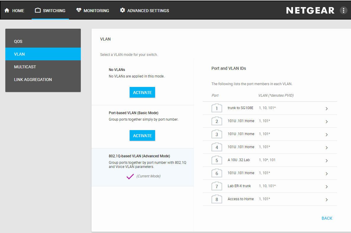

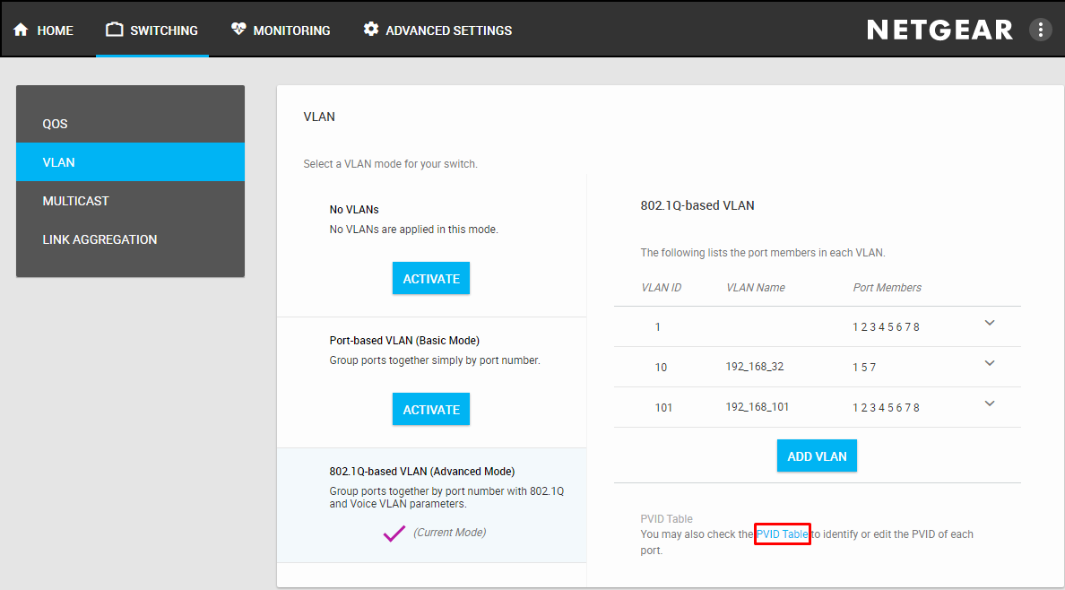

I don’t have a Netgear GS308EP but I do have a GS908E (a discontinued model).
On the GS908E, the “out of the box” config is the “No VLANs” dumb switch mode, where all ports are in the same broadcast domain, and the switch is vlan-transparent (meaning that it ignores the ethtype following the srcmac address in the ethernet header. So it can “relay” tagged frames, but not change them.
When you configure the switch with 802.1Q-based VLAN (Advanced Mode), it starts with only a single vlan defined (vlan 1 - with no name attached) and all ports as members of vlan 1. And all ports also have pvid set to 1. So all ports are access ports in vlan 1. For most situations this will appear to work the same as the “No vlan” mode, but it is not vlan-transparent, and any tagged frames will be dropped, so you can’t use this mode to transparently extend a trunk link, because all tagged frames will be dropped. You can define each vlan that will be in the trunk, but there is probably a limit (like 32) for the number of vlans you can define.
My belief is that the GSx08Ex devices (I assume this applies to the GS108E and GS308E devices as well as the GS908E) are always configured in “hybrid” mode, if hybrid means that there is a vlan associated with untagged frames. This is the PVID (the port vlan id), what Cisco calls the native vlan, and if you don’t change it, it will be set to vlan 1. As far as I know, there is no way to not have a PVID defined; about the only thing you can do to drop untagged frames is to create “port specific blackhole vlans” (e.g. 4001 for port 1 … 4008 for port 8 ) and then define the pvid to that blackhole vlan on each port. Then since there is only a single port that is a member of those blackhole vlans, the switch won’t have any other port to forward the untagged frame to, and it will just be dropped. But if you want to have vlan 99 be the untagged (native vlan, access vlan), then after you have added the port to the vlan membership for vlan 99, go to the “pvid table” screen and set the pvid to 99.
On the GS908E, the pvid will have a * beside it in the pvid table for each port.
Why waste our time with the wrong model, especially when you can easily find and download the correct user guide for the gs308e?
https://www.downloads.netgear.com/files/GDC/GS105EV2/WebManagedSwitches_UM_EN.pdf

  1. Took me a while to figure out the Netgear config. First, you’ll definite want the Advanced 802.1Q VLAN settings, otherwise you won’t be able to leave ports untagged. Then I realised that you have to add P1 (uplink trunk) to each VLAN as ‘tagged’, ie for VLAN20 to pass through from my Unifi on P2 to the Mikrotik, I had to configure Vlan20 as ‘tagged’ on P1 and P2. And for the security camera, VLAN50 as ‘tagged’ on P1 and ‘untagged’ on P4.
  2. My newly added vlan50 doesn’t seem to want to work yet. If I move the camera on p4 to BASE (99), it manages to grab an IP from the DHCP and I can connect to it. As soon as I move it to vlan50, it’s not able to get an IP. I also tried to set a static IP (192.168.50.5) but no joy connecting to it. Can’t see an obvious issue, but I wonder whether it’s actually an issue with my firewall settings. I’ll dig tomorrow with a fresh mind.
For reference (and in case it helps anyone with the same issues):
Current config for the Netgear
Current config for the Mikrotik (abbreviated)

Yes the logic on the netgear you applied makes sense.
P1 the uplink would need to be considered a trunk port, tagged with vlans 10,20,30,40 ( all going tagged to unifi ap on P2 ) and tagged with vlan 99 for two reasons,
a. because the switch needs it since its the management vlan where switch gets its IP etc.
b. because it will be sent to P2 as untagged, making P2 a hybrid port.
YOu want to change the pvid of p2 on the switch to 99.
So in effect, the pvids for all your ports on the switch should be left at the default of 1.
The ones that can be modifed are
  • P2, which you should change to 99.
  • p4 which you should change to 50
    = p5 which you should change to 50.
