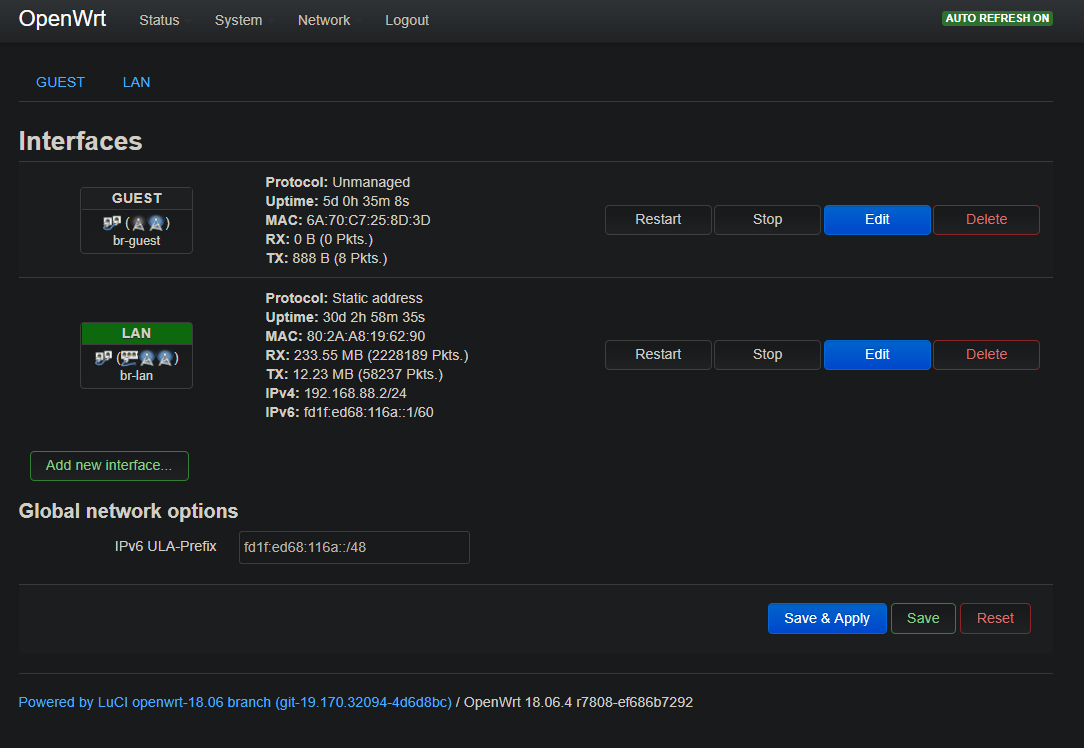

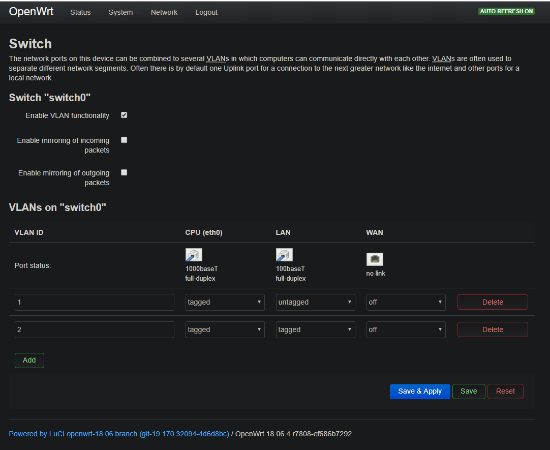

I have an Ubiquiti AC AP Pro with OpenWrt where I set up WLAN and WLAN GUEST as an Dumb AP (https://openwrt.org/docs/guide-user/network/wifi/dumbap).

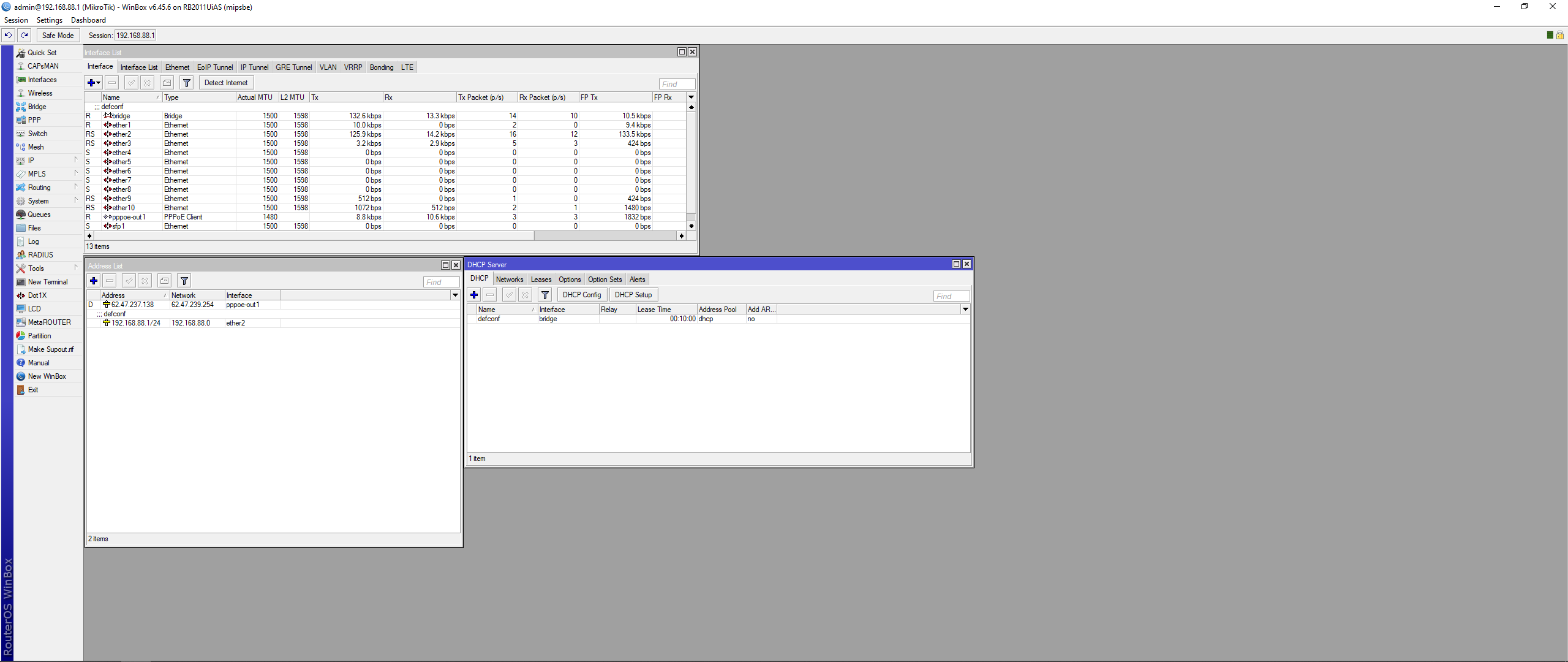

The AP is connect with my Mikrotik 2011UiAS on Ether2.
Ether1 is PPPoE mit DSL-Modem.
Ether3 is my NAS.
Ether4 is my Printer.
Now I want VLAN where the Guest Wlan is, with access to the printer.
And the other VLAN should have access to everything else, including the printer.
Somehow I dont know where to go, currently I have all interfaces connected with a bridge…do I need to set a VLAN for the bridge, or configure the tags for every interface on its own or…?
I am very new in this thematic…I have my current config and my wanted config attached, I hope someone can help me.
