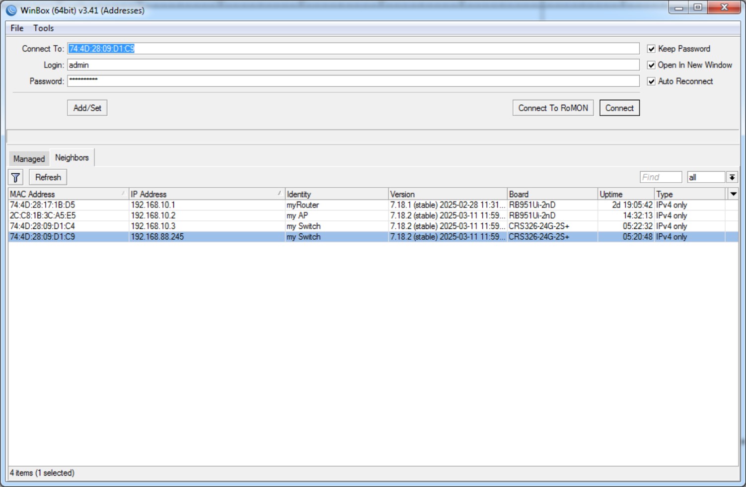

Everything works fine but i notice 2 problems:
  1. If i conect at any vlan-10 access port and open winbox shows all the Mikrotik devices in vlan10-test 192.168.10.0/24 subnet only.
    Afrter some time shows one more device 192.168.88.245 that is the device physical interface i am connected to mac address and bridge-trunk ip address, and i can connect to it by mac address
    not by ip.
  2. If i conect at any bridge-trunk hybrid port and open winbox shows all the Mikrotik devices in bridge-trunk 192.168.88.0/24 subnet only.
    Afrter some time shows also all Mikrotik devices that are in vlans i can connect to them by mac address not by ip.
Some time i mean is not standar… 5 minutes to 1 hour.
How i can prevent that 2 problems???

set discover-interface-list=all
You need to decide which VLAN is your trusted VLAN and create special interface list for it, for eg. mgmt.
Then you can set your discovery list to mgmt instead of all.
Also set your allowed interface list for winbox server to mgmt.
Then only devices that are on trusted vlan will be discovered and your device will be accessible only from that vlan.
