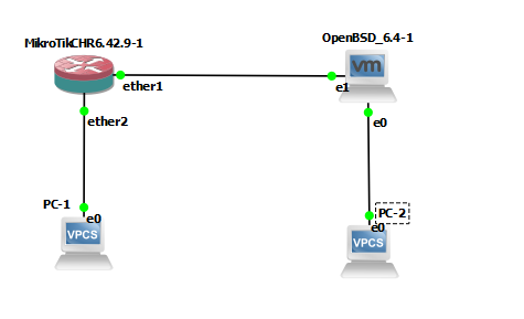

Trying out in a GNS3. One PC connected to Mikrotik CHR on eth2. Eth1 on Mikrotik CHR connected to OpenBSD.

DHCP server is on OpenBSD. vlan0 created and dhcp server setup to provide IP addresses. vlan id set correctly.
Now, PC1 is unable to obtain IP address from dhcp server on OpenBSD. I see traffic comming, I see reply from dhcp server offering and address (confirmed with tcpdump), traffic arrives on eth1 on Mikrotik (I see packets with tool sniffer) but is not being passed down to eth2 for some reason.
Exactly same setup works, just replacing OpenBSD with another CHR, with interface vlan created and dhcp server on it. So, my question is, is there anything that two Mikrotiks do automatically that makes it work and pass traffic?
For some reason I don’t think its an error on OpenBSD side, but I believe it is a vlan tag issue for some reason, but just can’t get to it.

Do I need an interface vlan in order to communicate with OpenBSD (trunk between these to)? I thought that was done by interface bridge vlan entries (ether1 tagged).
