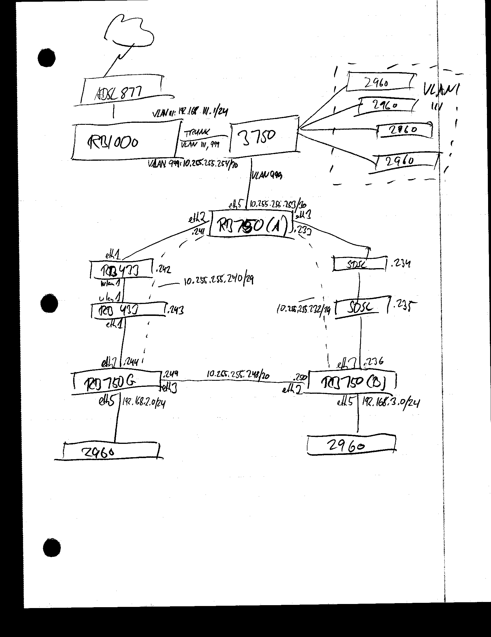

However, you could just redesign your network to not have end to end VLANs for VLAN 2 and VLAN 3. From your diagram I see absolutely no need whatsoever for 192.168.2.0/24 (VLAN 2) to be available on anything other than eth5 on the “RB 750G” router, or for 192.168.3.0/24 (VLAN 3) to be available on anything other than eth5 on the “RB 750 (B)” router. All other links between routers should be /30s - routed links, in other words. The RB750 routers become the layer 3 gateways for the two VLANs, and traffic back to the core is routed. Establish an OSPF area between all the involved routers and they’ll figure out how to get to each other automatically, including link failover, multiple active paths (if you want them), preferred paths, etc. This has many other advantages, such as you being able to control traffic via normal IP firewalls close to the packet source, and broadcast packets not propagating throughout the entire network. You may want to read up on “hierarchical networks”. While you are definitely going down the right path by converting your network from one large layer 2 topology to something more segmented, you’re just trying to go to multiple overlaid layer 2 topologies that all co-exist on the same physical paths. This approach is better than one large topology, but doesn’t fix most of the major drawbacks. It would be much more beneficial to instead go to multiple connected layer 3 topologies - in your case you actually wouldn’t really have to use VLANs 2 and 3 at all - they’d just be layer 3 networks on a routed port on the RouterBOARDs.
Re-reading my post before hitting the submit button I now think it’s fairly dense and confusing, I hope it makes sense in some fashion. You are trying to build a moderately complex network, so it’s kind of hard to cover it all in a few paragraphs.
Bored in a meeting. Here a quickie scribble of how I’d implement that network, keeping all the hardware you show exactly in its place. OSPF between all the routers, with either ECMP between the SDSL and WLAN paths, or one of them preferred due to more available bandwidth with the other only used for failover. Static gateways pointing to the “RB 750(A)” router on the WLAN bridges and the SDSL bridges (those static routes wouldn’t be used at all for routing customer traffic, only for administrative traffic - on the WLAN bridges, for example, the WLAN and copper interfaces are bridged, with the IP assigned to the bridge. Same for the SDSL bridges. Those links are layer 2 between the RB750s.
This doesn’t account for your VLAN 116. But that VLAN is not needed after migration, so I’d rather implement everything at once rather than migrate slowly. It also doesn’t account for your VLAN 114 - which isn’t needed, either. You don’t need an end to end management VLAN. You could make the links between the 2960s at the bottom and their RB750 uplink trunks, and carry two VLANs - one for users, one for management. But they would be local only between the switch and its immediate uplink. Alternatively you just give the switch an IP on the immediate client network and protect it from being accessed by sources from the client VLAN. Two VLANs is much cleaner, but would have made the drawing rather muddy.
