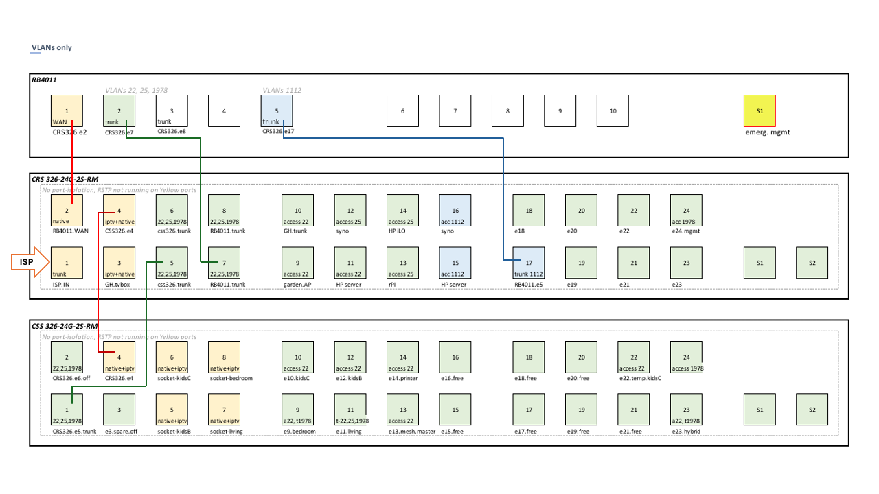

Overview:
Notes:
  • Colors have two meanings: (1) on CRS326 and CSS326 they show port-isolation groups, i.e. only ports of the same color can forward communication between themselves; (2) color also depicts the VLANs which should be available on these ports (yellow=ISP VLANs, green=internal VLANs, blue=special internal VLAN).
  • Under each port box you find information to where the cable from that port goes… (if empty, there is just a port number).
    Inside each port box you have information which VLAN it is carrying (in general, one VLAN number means it is access port – usually also includes text “access” or “acc” or “a##”; multiple VLAN numbers mean it is a trunk port with tagged VLANs; two ports on CSS326 – e9 and e23 – run in hybrid mode with access for 22 and tagged for 1978 – this is for testing purposes).
  • CSS326-ether11 runs a trunk to a TP-link smart switch, which is not shown on the picture but it is not relevant (just for info, everything works as expected for devices connected to the TP link)
  • Once setup is confirmed, I will run bonded connections (e.g. CRS 5&6 to CSS 1&2; CRS 7&8 to RB4011 2&3). But for now, bonds are not even defined and cables are not plugged-in, so there is just single cable link connecting switches/router as depicted.
  • On RB4011 ports are not bridged, everything is routed. VLAN interfaces for vlan 22,25,1978 are defined under ether2 and vlan interface for 1112 is defined under ether5. DHCP servers run on each VLAN interface with appropriate network definitions, ip pools, etc.

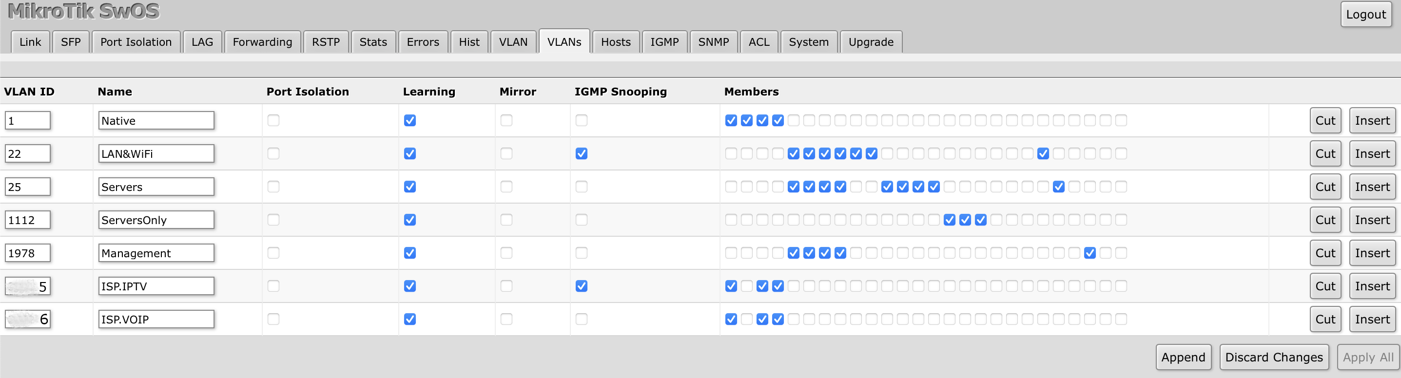

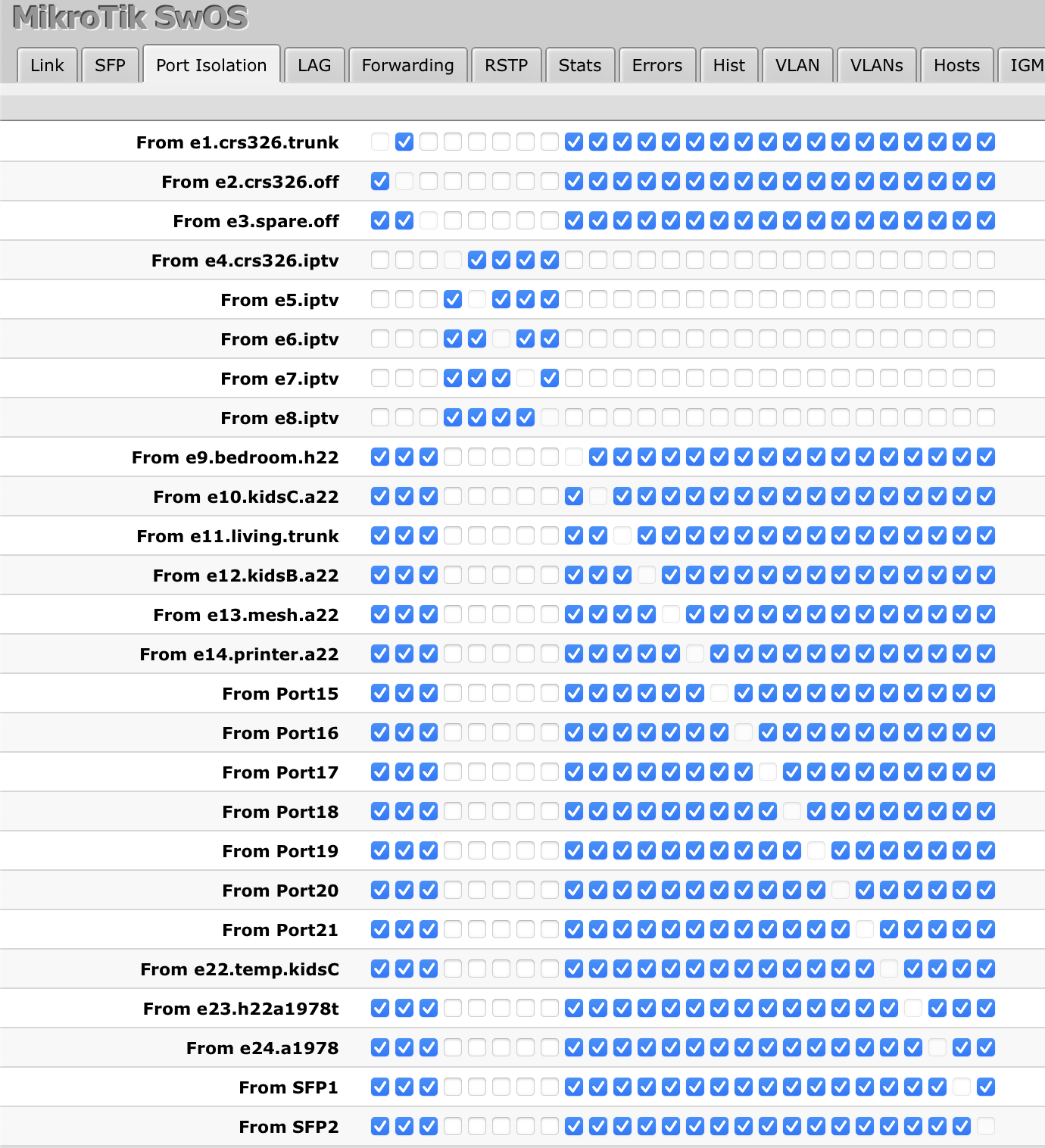

CRS326 configuration screens:
System
Port-isolation
RSTP
VLAN
VLANs

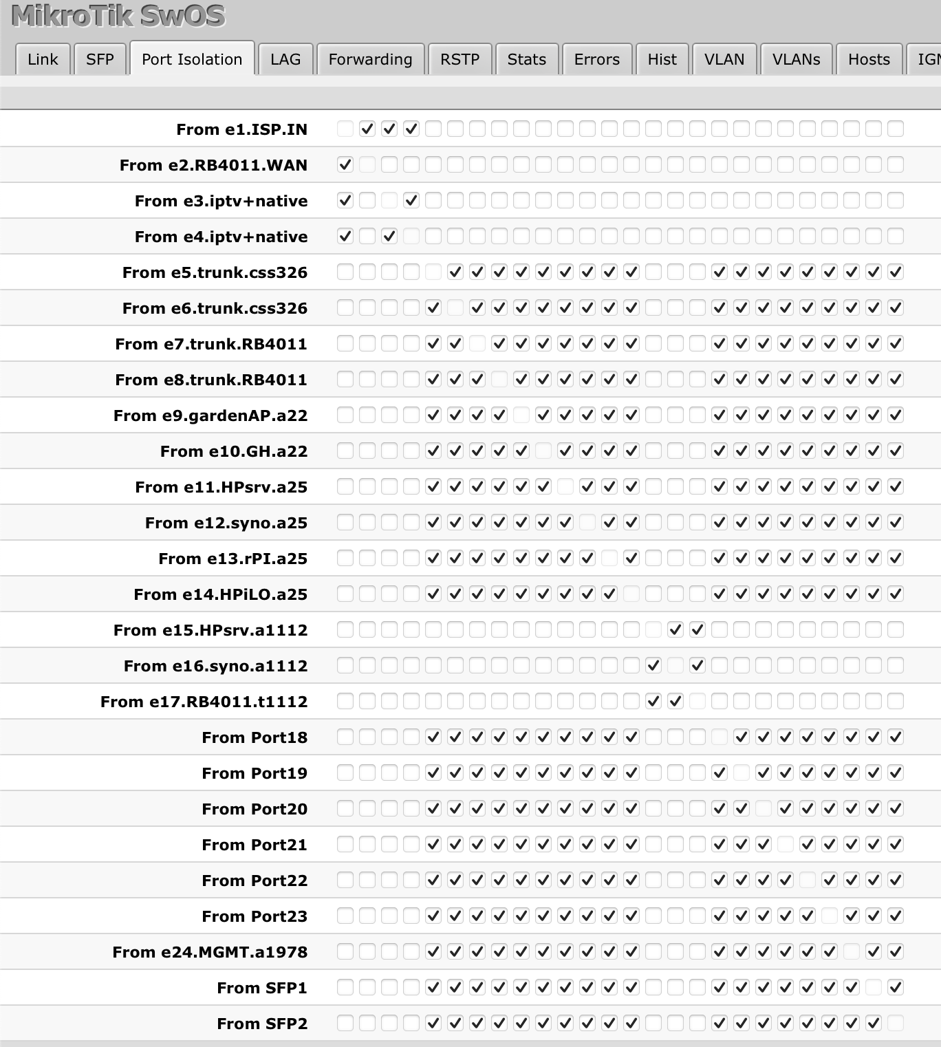

CSS326 configuration screens:
System
Port isolation
RSTP
VLAN
VLANs

I am not sure if anything beyond what I wrote in Notes above is necessary, but if yes, please let me know and I will post relevant export.

  1. Can we please clarify relationship between port isolation and vlans? Specifically, it is usually simply siad “using both could cause problems”, but that is too generic. Sub-questions:
  2. Does it hurt if I have both applied, as per my setup?
  3. If I disable (un-tick) Port-isolation on VLAN screen, does the port-isolation definition get ignored? If yes, does it then hurt to have the port isolation defined “just in case”, if it is ignored?

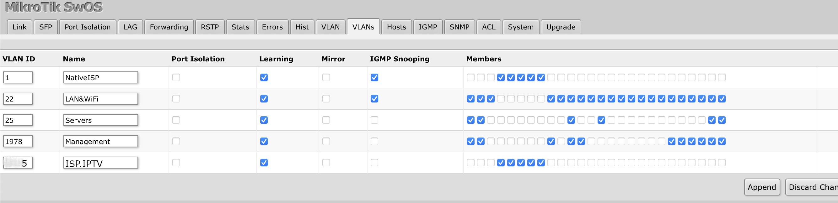

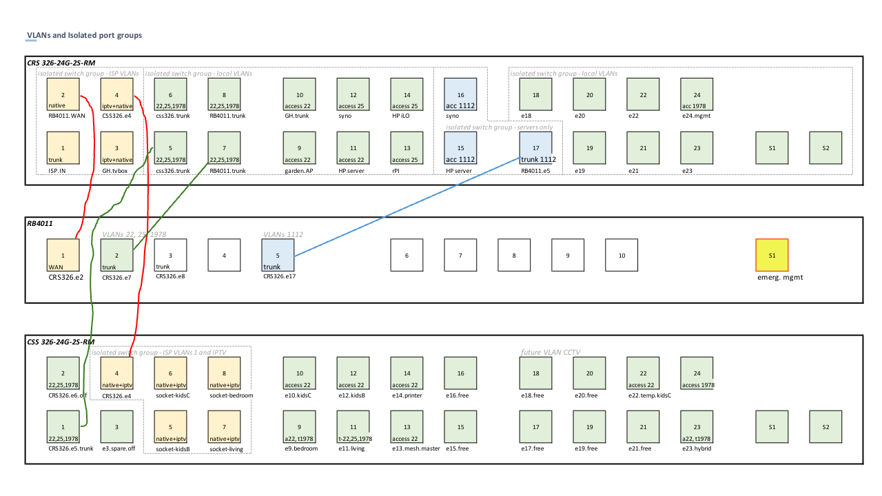

As a follow-up for future readers, here is the revised configuration:
What has changed (besides nicer layout):
  • there are no isolated switch groups on any of the two switches, which is later reflected in configuration of each switch. All ports can forward traffic between themselves.
for switches I will not show all screenshots again, I’ll just summarise the configs
C**R**S326
Port isolation - default configuration = all ports can forward traffic to all ports

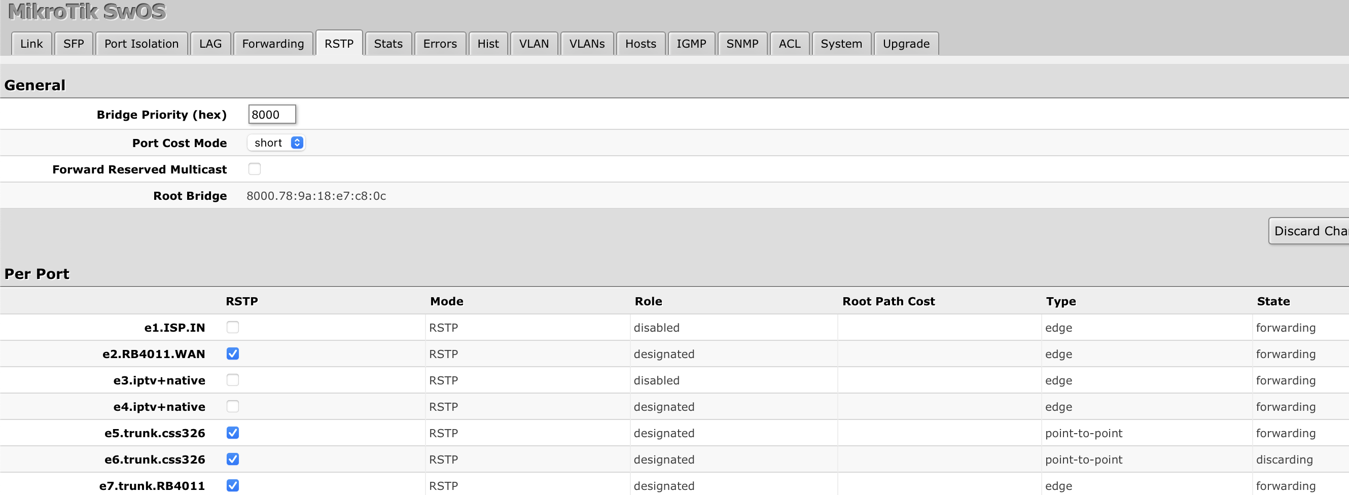

RSTP - disabled on yellow ports (except e2.RB4011.WAN) and enabled on all green and blue ports - perhaps it could be enabled, but I do not want my switches to interfere with STP running on ISP network (although I think they can handle that from their side).

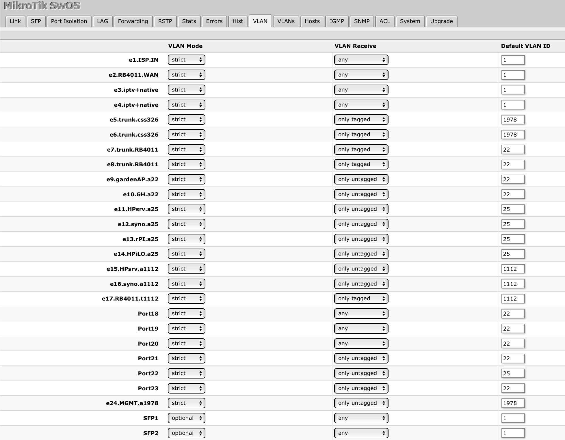

VLAN
  • yellow ports e1-e4: VLAN mode = enabled; VLAN receive = any; Default VLAN ID = 1
  • green and blue ports: VLAN mode = strict; VLAN receive = tagged / untagged / any (trunk / access / hybrid); Default VLAN ID = 22
VLANs
  • VLAN 5 (iptv): Port isolation = no; Learning = yes; Mirror = no; IGMP Snooping = yes; Members = e1, e3, e4
  • VLAN 22: Port isolation = no; Learning = yes; Mirror = no; IGMP Snooping = yes; Members = e5-e10; e18-e23
  • VLAN 25: Port isolation = no; Learning = yes; Mirror = no; IGMP Snooping = no; Members = e5-e8; e11-e14; e18-e23
  • VLAN 1112: Port isolation = no; Learning = yes; Mirror = no; IGMP Snooping = no; Members = e15-e17
  • VLAN 1978: Port isolation = no; Learning = yes; Mirror = no; IGMP Snooping = no; Members = e5-e8; e24

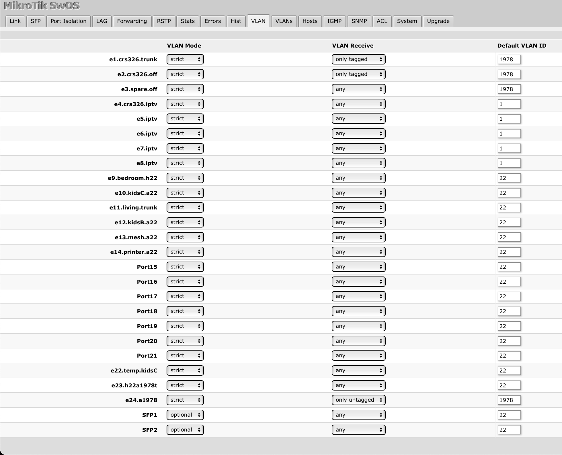

C**S**S326
RSTP - disabled on yellow ports (e4-e8) and enabled on all green ports - perhaps it could be enabled, but I do not want my switches to interfere with STP running on ISP network (although I think they can handle that from their side).
VLAN
  • yellow ports e4-e8: VLAN mode = enabled; VLAN receive = any; Default VLAN ID = 1
  • green ports: VLAN mode = strict; VLAN receive = tagged / untagged / any (trunk / access / hybrid); Default VLAN ID = 22
VLANs
  • VLAN 5 (iptv): Port isolation = no; Learning = yes; Mirror = no; IGMP Snooping = yes; Members = e4-e8
  • VLAN 22: Port isolation = no; Learning = yes; Mirror = no; IGMP Snooping = yes; Members = e1-e2; e3; e9-e23
  • VLAN 25: Port isolation = no; Learning = yes; Mirror = no; IGMP Snooping = no; Members = e1-e2; e11
  • VLAN 1978: Port isolation = no; Learning = yes; Mirror = no; IGMP Snooping = no; Members = e1-e2; e24

Since I have disabled RSTP on yellow ports and I have 2 cables running between the switches (e4-e4 yellow; e5-e1 green) - will that create a loop or not, given my VLAN configuration? (my understanding is, that yellow carries only VLAN 5 and untagged “1”; green carries only VLAN 22, 25, 1978 and untagged “22”… but I am not sure).
Because if it does create a loop, then I have to go mkx way…

UPDATE:
I plugged in iptv cables, but tvboxes were receiving only IPs from ISP related to internet and not iptv.vlan.
Solution was to add another VLAN 3 (working name is ISP Native), and the assignment is as follows:
CRS326
ports e1 and e2 have default VLAN ID = 1
ports e3 and e4 have default VLAN ID = 3
The new VLAN 3 is defined as: Port isolation = no; Learning = yes; Mirror = no; IGMP Snooping = yes; Members = e1 - e4
CSS326
ports e4-e8 have default VLAN ID = 3
The new VLAN 3 is defined as: Port isolation = no; Learning = yes; Mirror = no; IGMP Snooping = yes; Members = e4 - e8
So input from ISP and Router WAN port stay on default VLAN ID =1, tv_boxes besides having iptv.vlan 5 (tagged) also need custom VLAN (in my case 3) which is used as default VLAN ID for untagged traffic.

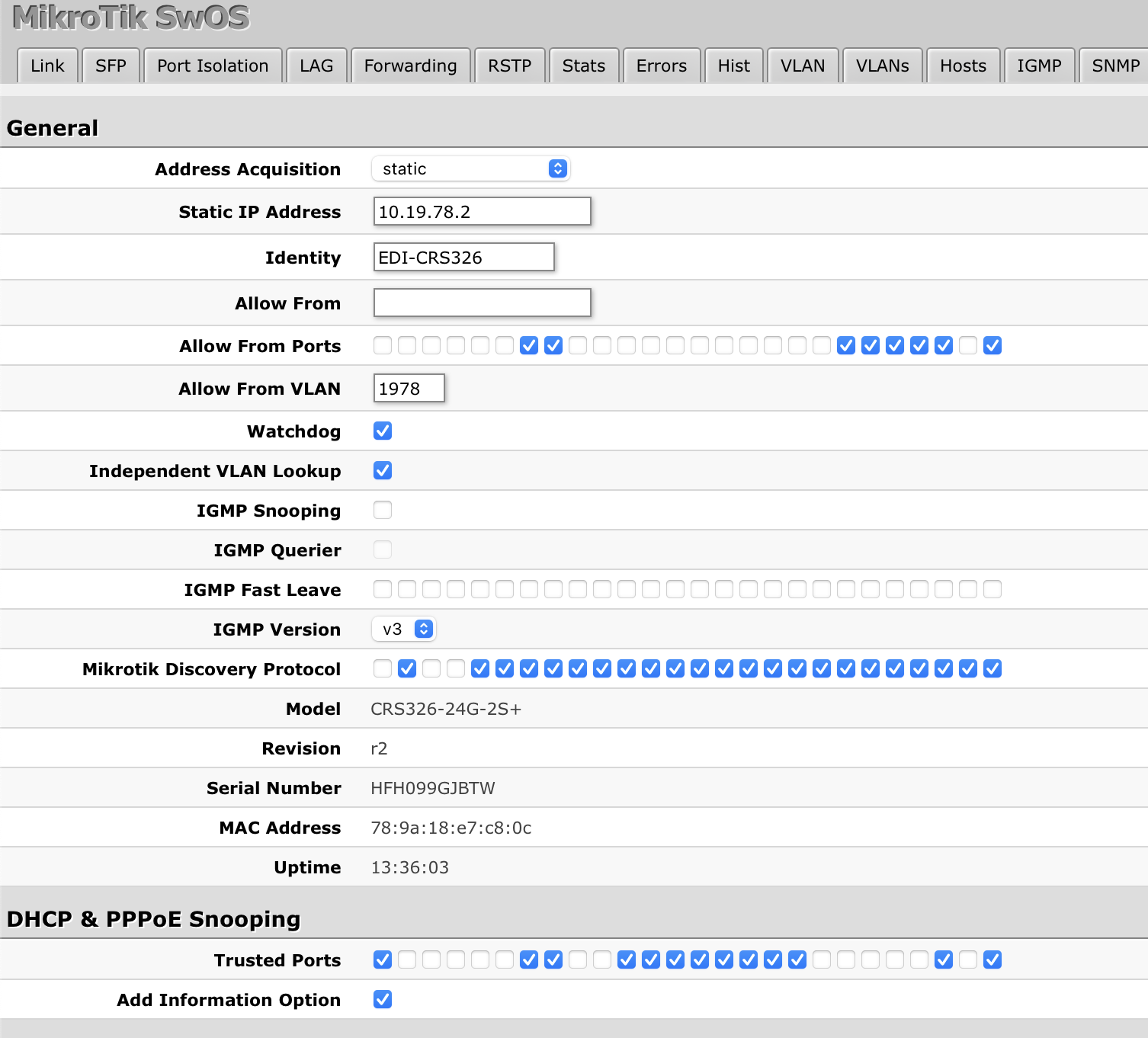

I will add (perhaps unrelated) additional questions, because I am also experiencing some strange behavior on some ports (e.g. look at CSS326 port 10 and port 22 – exactly the same setup, in ether 10 the mesh master does not work, in port 22 it does…)
Meantime I have found the culprit. VLAN setup was exactly the same, but on System tab non-working ports were marked as not trusted.
Now the official documentation confuses, so can someone please explain it to me:
SwitchOS documentation
Trusted ports
Group of ports, which allows DHCP or PPPoE servers to provide a requested information. When enabled, it allows forwarding DHCP client packets towards the DHCP server through this port. Mainly used to limit unauthorized servers to provide malicious information for users, access ports usually do not configure as trusted. Ports that receive DHCP client packets with already added Option-82 must also be trusted, otherwise these packets are dropped. The setting does not apply to DHCPv6 packets.
From that I deducted that “Access ports should normally not be trusted” (which makes logical sense to me). But since I only get IP from DHCP on these servers only when access ports are trusted (“When enabled, it allows forwarding DHCP client packets towards the DHCP server through this port.”) then it seems to be totally contrary statements.
So what should I do? Keep all trusted? Or should I disable the Option-82?
Regarding loop between yellow and green parts: if you’re careful not to pass same VLAN (tagged or as native) via multiple ports, then there won’t be a loop. RSTP or plain STP would detect a loop (their BPDUs disregard VLAN IDs), MSTP would be fine.
Another remark (it can be called personal preference): I never pass untagged frames between two LAN infrastructure devices … or worded differently: all my LAN infrastructure interconnects are strictly trunk ports.
Benefit, applied to your setup: you could either use single interconnect between RB4011 and CRS and single interconnect between CRS and CSS. And for that I’d use DAC cables between devices’ SFP+ ports (10 Gbps). Alternatively you could use pairs of UTP cables in 802.3ad bond (somehow increases bandwidth and more importantly adds redundancy) between each pair of devices..

@mkx - SPF connection is no-go for me, as the infrastructure is already buried in the walls. But I plan to run bonds, so I will eventually move to that solution.
As for the trusted ports part, turns out that I needed to turn of the DHCP Option-82 part.
Once turned-off, then the Trusted ports work as I thought - meaning disable trusted port on access ports, keep it on trunks. For ISP part of the network, you can experiment, but I kept it on trusted, as my clients (router WAN and tvboxes) need to get IP from ISP.
So thanks again for helping me out. It’s been running for a few hours now without an issue, so I hope it stays that way.
I hope this helps someone else as well.
Cheers,
B.
