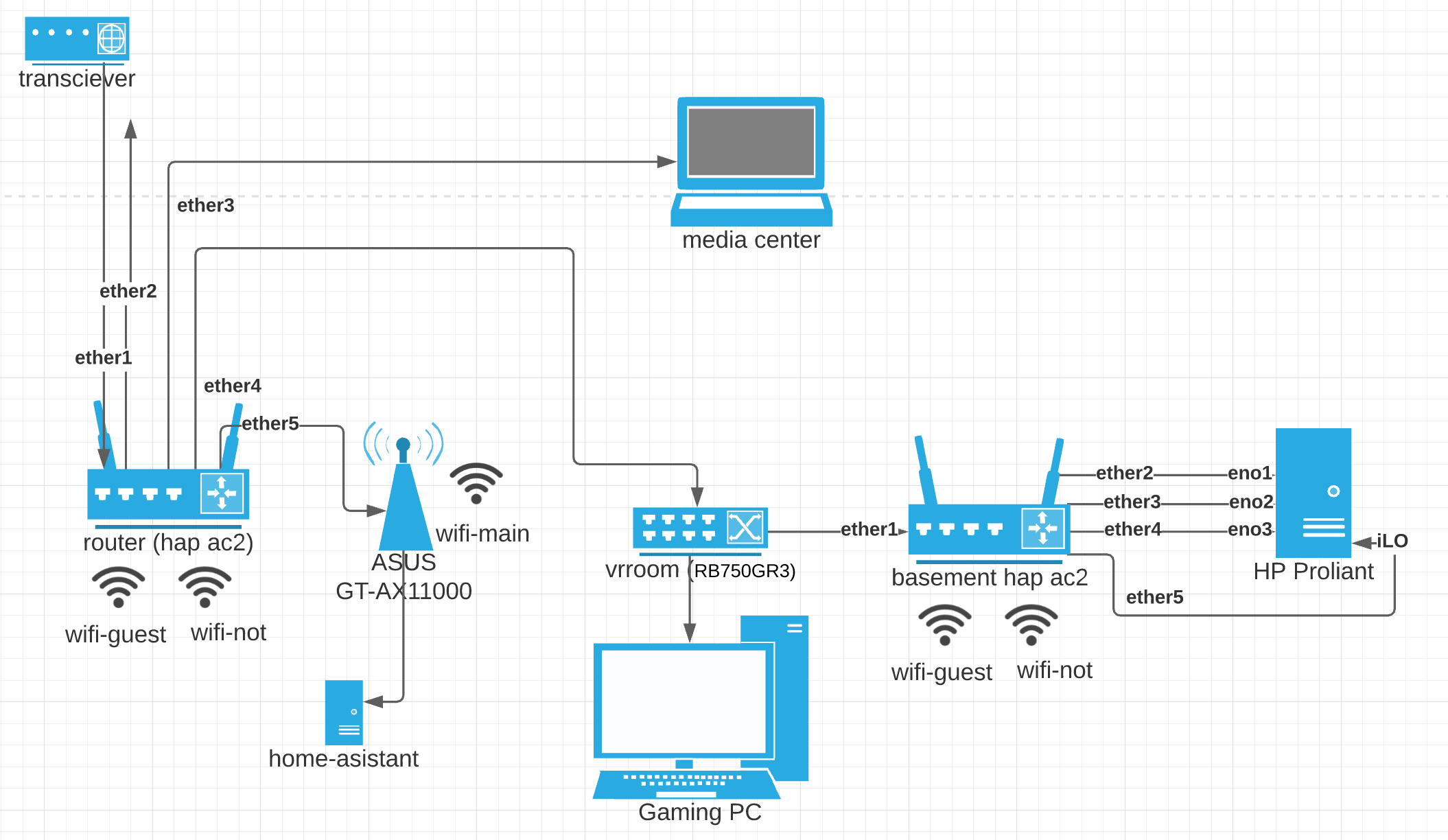

To understand your config would then need a diagram to match it up against.
Here it is:
Assuming then
wifi-guest users should be on guest-vlan
wifi-not users should be on not-vlan
everything else is home van??
are there wired guest or not users??
any other groups you need to segregate??
Home users should be on home-vlan (includes wifi main ), home asistant, gaming pc, media centre, (one of the ether ports on the HP (there are four but not way to know what for??)
All smart devices should get an IP from the home-vlan being the managment vlan??
ASUS, home asist (assuming its a smart device), vrrrom, basement hapac possibly one port on the HP proliant.
The hp proliant is the unknown here in how it functions and purpose .
Non vlan aware devices include, asus, media centre, gaming pc, hp proliant???
Vlan aware devices include both hap acs, hom assist, vrroom, hp proliant???
  • wifi-guest users should be on quest-vlan (101)
  • wifi-not users should be on not-vlan (103)
  • gaming pc, media center, wifi-main users should be in main-vlan (100) - they should get IP from 10.0.0.0/24
  • there are no wired “guest” or “not” users at the moment
  • all smarthome devices (like vacuum cleaner, IP cameras, LED bulbs with WiFi support) should connect to “wifi-not”, i.e. vlan 103 (this network will have no access to the internet, only to LAN) - they should get IPs from 10.3.0.0/24
  • my house guests will connect to the wifi-guest, i.e. vlan 101 (this network will have only access to the internet, no LAN access), will be getting IPs from 192.168.1.0/24
  • home assistant should have access to two networks: “main” (10.0.0.0/24) and “not” (10.3.0.0/24)
  • HP Proliant server is a homelab, with various features (NAS, media-server, reverse-proxy, some hobby web projects - those on the “main” network. But there are various cases, like setting up a Factorio server for LAN parties: guests will connect to wifi-quest and server will be able to be hosted in the vlan 101). I want this machine to be able to connect to anything, but I wanted to have one “vlan-main”-only connection in case something goes bad with network configuration. The iLO interface, being the special case, I want to keep separated for security reasons (so I’m able to whitelist in firewall only certain machines to be able to reach it) - it will be connected to the “service” vlan (102) (10.2.0.0/24)
  • currently, the “main” network is the management network for all the Mikrotik devices. At this point I’m too afraid of losing access to those by using dedicated management vlan. Once I’m fully aware and familiar of how Mikrotik devices work and how the network is operating, I will rework the Mikrotik-management to be on “service” vlan, just like Proliant’s iLO interface.
vlan aware devices:
  • both hap acs, vrroom-routerboard (I hope), home assitant, one of the interfaces of hp proliant
    vlan unaware devices:
  • asus, media centre, gaming pc, 3 interfaces of hp proliant

/interface ethernet set [ find default-name=ether4 ] name=ether4-service
/interface ethernet set [ find default-name=ether5 ] name=ether5-not
/interface vlan add interface=BR1 name=vlan-main-100 vlan-id=100
/interface list add name=MAIN
/interface list add name=LAN
/interface wireless security-profiles set [ find default=yes ] supplicant-identity=MikroTik
/interface wireless security-profiles add authentication-types=wpa2-psk mode=dynamic-keys name=guest-security-profile supplicant-identity=MikroTik
/interface wireless security-profiles add authentication-types=wpa2-psk mode=dynamic-keys name=not-security-profile supplicant-identity=MikroTik
/interface wireless security-profiles add authentication-types=wpa2-psk mode=dynamic-keys name=main-security-profile supplicant-identity=MikroTik
/interface wireless set [ find default-name=wlan1 ] frequency=auto mode=ap-bridge security-profile=guest-security-profile ssid=guest
/interface wireless add mac-address=4A:8F:5A:27:57:F0 master-interface=wlan1 name=wlan1-not security-profile=not-security-profile ssid=not
/interface wireless set [ find default-name=wlan2 ] frequency=auto mode=ap-bridge security-profile=main-security-profile ssid="main 5GHz"
/interface bridge port add bridge=BR1 frame-types=admit-only-untagged-and-priority-tagged ingress-filtering=yes interface=ether2-main pvid=100
/interface bridge port add bridge=BR1 frame-types=admit-only-untagged-and-priority-tagged ingress-filtering=yes interface=ether4-service pvid=102
/interface bridge port add bridge=BR1 frame-types=admit-only-untagged-and-priority-tagged ingress-filtering=yes interface=ether5-not pvid=103
/interface bridge port add bridge=BR1 frame-types=admit-only-untagged-and-priority-tagged ingress-filtering=yes interface=wlan2 pvid=100
/interface bridge port add bridge=BR1 frame-types=admit-only-untagged-and-priority-tagged ingress-filtering=yes interface=wlan1 pvid=101
/interface bridge port add bridge=BR1 frame-types=admit-only-untagged-and-priority-tagged ingress-filtering=yes interface=wlan1-not pvid=103
/interface bridge port add bridge=BR1 frame-types=admit-only-vlan-tagged ingress-filtering=yes interface=ether1-uplink-trunk
/interface bridge port add bridge=BR1 frame-types=admit-only-vlan-tagged ingress-filtering=yes interface=ether3-trunk
/ip neighbor discovery-settings set discover-interface-list=all
/ip settings set ip-forward=no
/interface bridge vlan add bridge=BR1 tagged=BR1,ether1-uplink-trunk,ether3-trunk untagged=wlan2 vlan-ids=100
/interface bridge vlan add bridge=BR1 tagged=ether1-uplink-trunk,ether3-trunk untagged=wlan1 vlan-ids=101
/interface bridge vlan add bridge=BR1 tagged=ether1-uplink-trunk,ether3-trunk vlan-ids=102
/interface bridge vlan add bridge=BR1 tagged=ether1-uplink-trunk,ether3-trunk untagged=wlan1-not vlan-ids=103
/interface list member add interface=vlan-main-100 list=MAIN
/interface list member add interface=ether1-uplink-trunk list=LAN
/interface list member add interface=ether2-main list=LAN
/interface list member add interface=ether3-trunk list=LAN
/interface list member add interface=ether4-service list=LAN
/interface list member add interface=ether5-not list=LAN
/ip address add address=10.0.0.10/24 interface=vlan-main-100 network=10.0.0.0
/ip route add distance=1 gateway=10.0.0.1
/ip service set telnet disabled=yes
/ip service set ftp address=10.0.0.0/8 disabled=yes
/ip service set www address=10.0.0.0/8
/ip service set ssh address=10.0.0.0/8
/ip service set api address=10.0.0.0/8 disabled=yes
/ip service set api-ssl address=10.0.0.0/8 disabled=yes
/system clock set time-zone-name=Europe/Warsaw
/system identity set name=basement
/system ntp client set enabled=yes server-dns-names=europe.pool.ntp.org
Okay I see this…
The question I have is where does vlan100 originate from…
In other words why are you defining vlan100 here at all. I think this is the issue
I noted you defined vlan100 as you should all the vlans on the hapac as being given a vlan number and with interrface BR1
I am assuming you only showed vlan100 with the proper vlan assignment as its the problem child.
I think if you get rid of that address entry, it should start working.
OTHER SMALL ITEMS.
I would change this from
TO
/interface bridge vlan add bridge=BR1 tagged=BR1,ether1-uplink-trunk,ether3-trunk untagged=wlan2,eth2-main vlan-ids=100
(note: it should not be needed to add wlan2 or eth2 untagged as the bridge should do it automatically but I like to visually map to my bridge ports).
This I would probably modify to simplify
From
TO
/interface list member add interface=BR1 list=LAN
As it turned out, it started to work by itself! Must’ve been some caching issue, maybe I was too eager to simply wait for some tables to timeout.
Oh, and I put the IP there, because I need this switch to have an IP for mgmt access.
Thank you for your tips, I really appreciate all your help!
true dat, I forgot LOL. Glad its working!!
