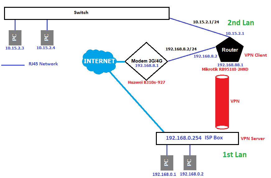

Hi
I’m new here and i have some problem, hope you can help me
Here my configuration:
  • 1st lan (192.168.0.0/24) : VPN server (fix IP address)+ others pc’s
    (no router just the FAI box)
    gtw is 192.168.0.254
  • 2nd lan (10.15.2.0/24): VPN client (dynamic IP address) + 4g modem + Mikrotik router (RB951UI-2HND) + switch + pc’s
    gtw is 10.15.2.1
Regarding the vpn configuration, i follow http://www.urosvovk.com/step-by-step-how-to-configure-a-pptp-vpn-client-on-mikrotik-routeros/

I can successfully ping all my devices located in the 1st lan from 2nd lan
I cannot ping any devices located in the 2nd lan from 1st lan (I cannot ping from 192.168.0.1 towards 10.15.2.3 or any other devices)
Can someone help me to allow 1st lan connect 2nd lan ?
Thank you

What about routes? Does VPN server know where to look for 10.15.2.0/24?
Here the route i have

It looks like routes from 2nd LAN router (VPN client). I mean routes from 1st LAN router (VPN server).
Hi
I don’t have any router on the 1st lan (VPN server side), only ISP box with 192.168.0.254 private ip address
All device on 1st lan are 192.168.0.0/24
Ok, not router, but VPN server needs to know where 10.15.2.0/24 is. Does it? Because if it doesn’t, it will send all traffic to 10.15.2.0/24 to its default gateway and it has no chance to reach the destination (VPN client) from there.
When connecting from LAN2 to LAN1, masquerade rule on pptp-out1 make all traffic look like it’s from the single IP address that VPN client got from VPN server, so it works, because VPN server obviously knows where that address is.
But to reach LAN2 from LAN1 (or VPN server itself), VPN server must have route to it, expressed as RouterOS config it would be:
add dst-address=10.15.2.0/24 gateway=<VPN client address>
And then you also wouldn’t need the masquerade rule anymore.
Hi
NO
IP address of vpn client side is 192.168.27.66, so i did
add dst-address=10.15.2.0/24 gateway=192.168.27.66
but no success
I hope I didn’t confuse you with RouterOS syntax (I’m just used to it), you did this on ISP Box / VPN Server (in some equivalent way used by that device), right?
If so and it doesn’t work, check what happens. Try to use Tools->Torch on client’s VPN interface and watch for incoming packets to 10.15.2.x, while trying to connect there from server side. If there are some, the part with route worked. Then you can check if they pass through router and go to LAN interface where 10.15.2.0/24 is. If not, you can have a firewall blocking them.
I did this on mikrotik (client side)
I don’t have any routeur on the 1st lan

Something strange i see 95.154.216.16 ip, i don’t know it
It won’t help you on client side, it’s the VPN server that must know where 10.15.2.0/24 subnet is. And currently doesn’t. So you must find a way how to add this route on VPN server. Or if you’d in fact need to access only some service in 10.15.2.0/24 network (and not the whole network), you could do it using port forwarding. In other words, devices from 1st LAN would be connecting to IP address of VPN client (192.168.27.66) and you’d forward port(s) from there to 10.15.2.x.
And that adress you don’t know, downloading /mikrotik.php and enabled SOCKS proxy, I’m affraid I have some bad news for you, it looks like hacked router, see Winbox vulnerability: please upgrade. Not very surprising, since you have no firewall (you have some rules, but they allow absolutely everything).
